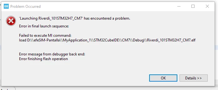

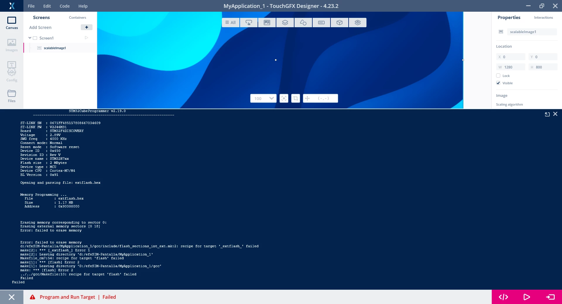

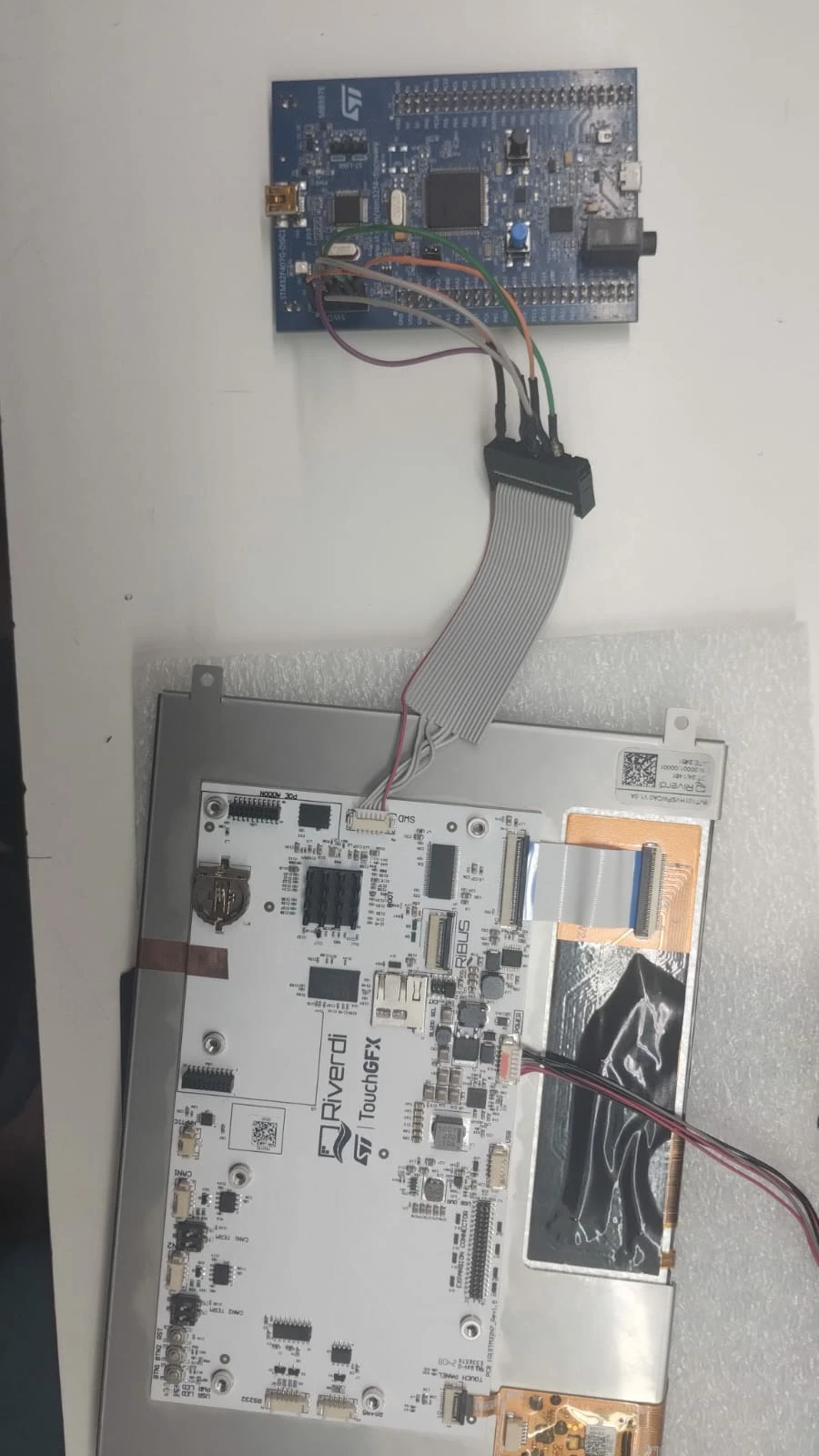

I’m experiencing issues while programming the RVT101HVSFWCA0 Riverdi display. Specifically, I encounter errors when uploading my project using TouchGFX and STM32CubeIDE.
I would greatly appreciate your assistance in resolving this matter. I’ve attached a screenshot showing the errors and my current connection setup.
Best answer by GaetanGodart
Hello @Matiasefe_95 ,
Can you try to connect your board to STM32CubeProgrammer and erase memory then flash your elf.

Pavel A.
April 9, 2025
This is an error erasing the external flash. Check the "external loader" selected for your board - is it correct?

I am generating my project using the model selected in the TouchGFX application. From there, I import it into the STM32CubeIDE workspace. However, when I try to upload the project either from TouchGFX or STM32CubeIDE, I
get the this error.This is the model I've been using.

Tesla DeLorean
Guru
April 9, 2025
Ok, but it needs an External Loader associated with the QSPI memory at 0x90000000.
This file needs to be referenced in the project's metadata, and the .STLDR file needs to be in a directory that is readable/usable by STM32 Cube Programmer as it's called from the IDE

Matiasefe_95
April 9, 2025
HI!,I used the "Erase Full Chip" function in version 2.18 of the STM32 Programmer, but the application window froze at 100%, and the programmer's red and green multi-color LEDs started flashing. It has been in this state for approximately 40 minutes. In the STM32 Programmer, I can see that all memory addresses are showing FF. Is this expected behavior?
