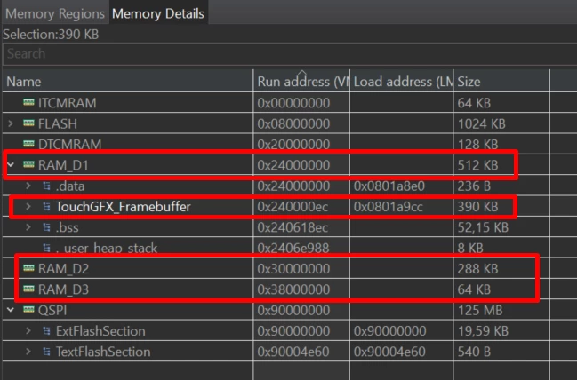

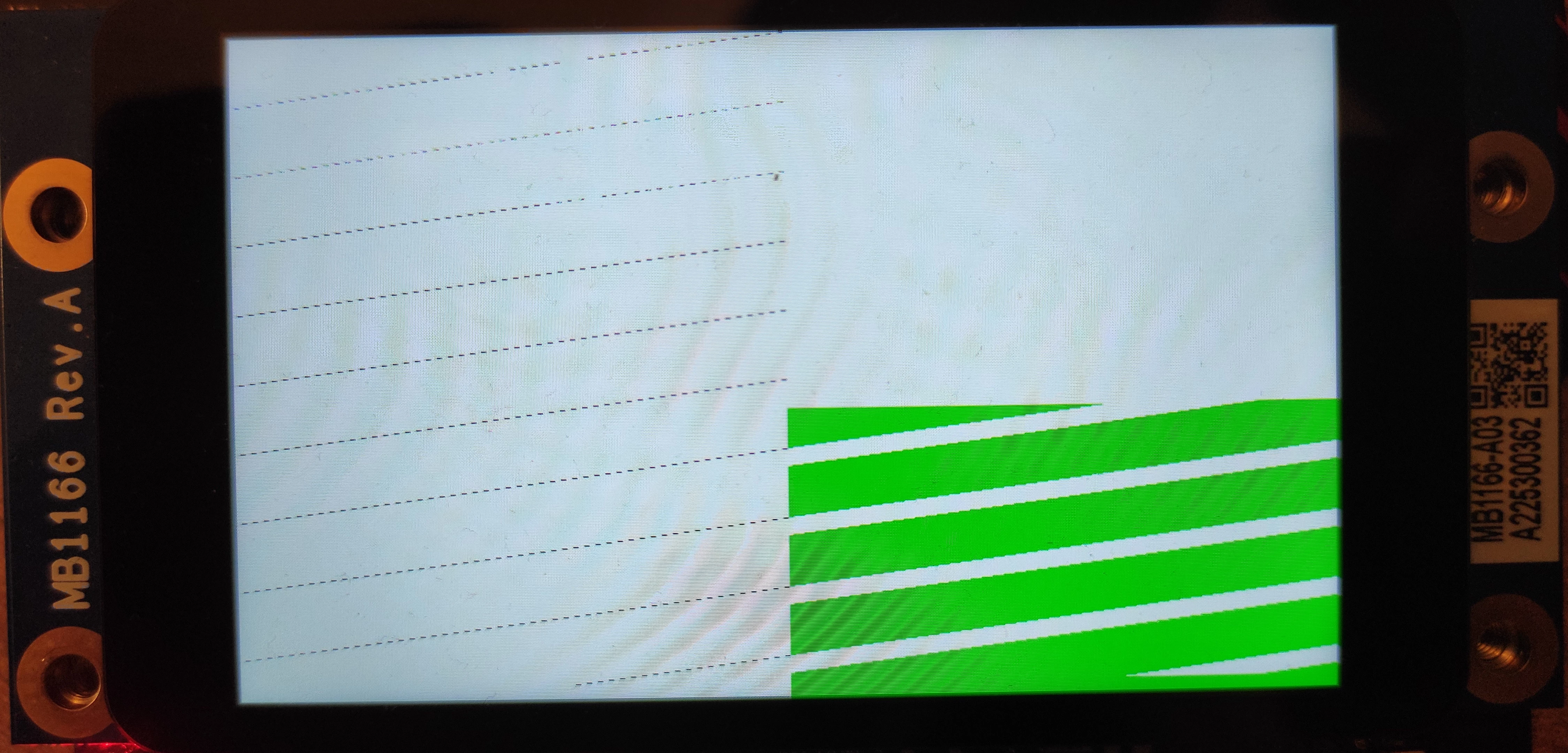

I have a STM32H747I-DISCO touchGFX project that has a 8-bit color depth and it is working very well, when I use external RAM for frame buffer. But when I disable external RAM and use internal RAM for the frame buffer by applying these instructions in the link below, I see partly corrupted screen.
Ref:https://support.touchgfx.com/docs/development/board-bring-up/how-to/03-display-internal
and this is the original screen:
Should I do something else that is not written in the 'Display with framebuffer in internal RAM' instruction?
Thanks for the answers

MMenz.1
Jan 10, 2024 12:42 PM UTC
Your controller has multiple internal RAM blocks. Can you try anther one? Looks like an alignment problem
GökhanAuthor
Jan 10, 2024 1:05 PM UTC
@MMenz.1 Thank you for your reply but I can not use other RAM blocks because of frame buffer size. What do you mean with alignment problem? Can you explain? Thanks!
MMenz.1
Jan 10, 2024 2:27 PM UTC
DMA often can only access 32bit aligned addresses. When your buffer starts at another address it may lead to shredded images.
GökhanAuthor
Jan 10, 2024 1:11 PM UTC
By the way, this is another example.
MMenz.1
Jan 10, 2024 3:00 PM UTC
Are you sure that you have only changed the location of the buffer? it locks a bit like your array dimensions are incorrect. I find it easier to identify when you place small squares with different colors in each corner.

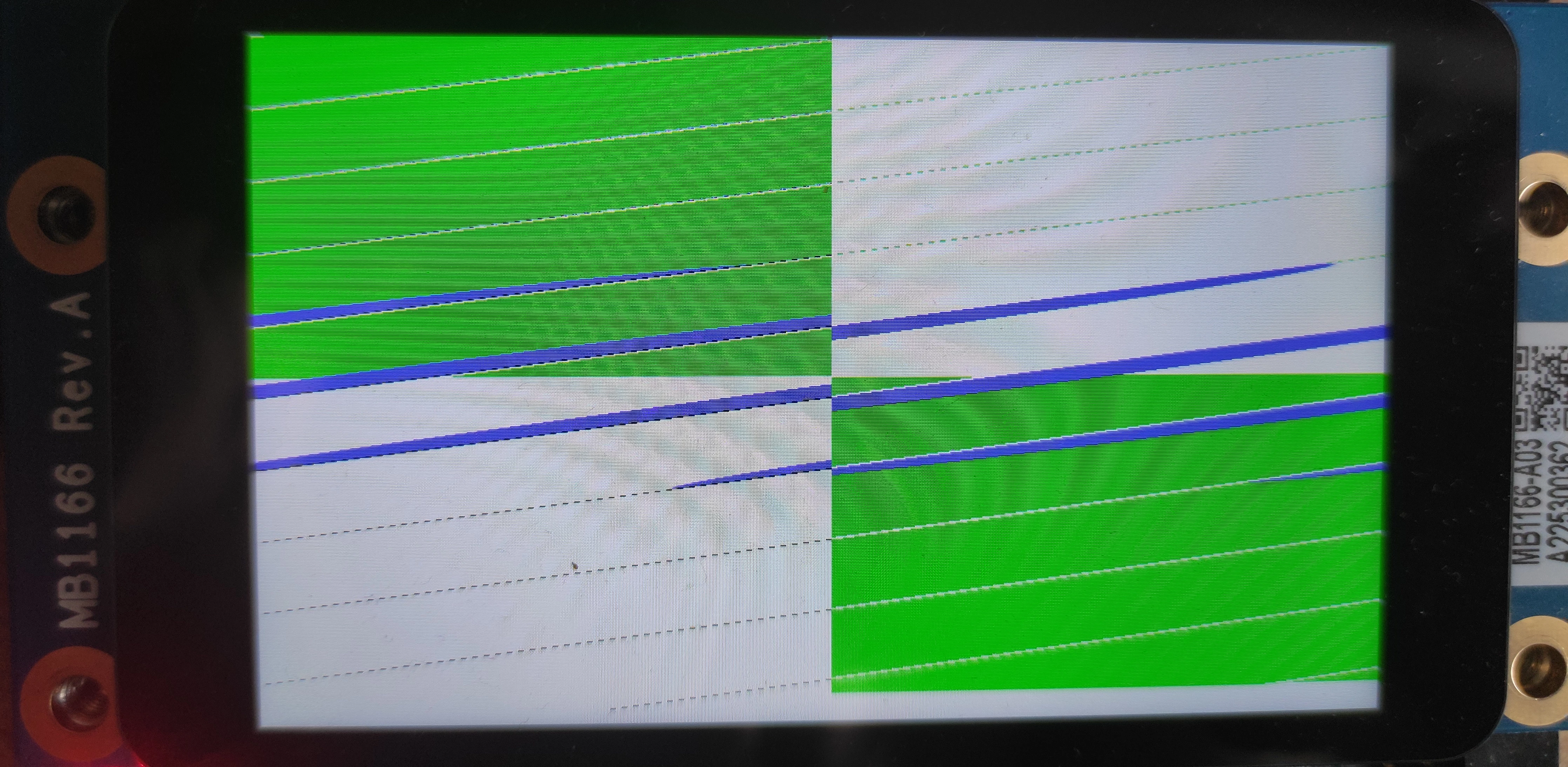

GökhanAuthor
Jan 10, 2024 9:42 PM UTC
One more update... It seems the problem is not about frame buffer. I connected to the MCU with debugger to review frame buffer memory region (in internal RAM). Every byte is in correct place. But I found something else. When I comment out LCD_SetUpdateRegionLeft() in HAL_DSI_TearingEffectCallback() (TouchGFXHAL.cpp), half of the screen is working without any problem.
void HAL_DSI_TearingEffectCallback(DSI_HandleTypeDef* hdsi)
 GPIO::set(GPIO::VSYNC_FREQ);
 HAL::getInstance()->vSync();
 OSWrappers::signalVSync();
 // In single buffering, only require that the system waits for display update to be finished if we
 // actually intend to update the display in this frame.
 HAL::getInstance()->lockDMAToFrontPorch(refreshRequested);
 if (refreshRequested && !displayRefreshing)
 // Update region 0 = first area of display (First quarter for 16bpp, first half for 24bpp)
 updateRegion = 0;
// LCD_SetUpdateRegionLeft();
 // Transfer a quarter screen of pixel data.
 HAL_DSI_Refresh(hdsi);
 displayRefreshing = true;
 else
 GPIO::clear(GPIO::VSYNC_FREQ);
 But when I uncomment it, screen is not working. Here is the result images:
Original image (from touchGFX designer):
When I comment out LCD_SetUpdateRegionLeft(), right side of the screen is working without any problem:
When I uncomment LCD_SetUpdateRegionLeft(), screen is not working. Pixels are not at correct places:
What can be the possible reasons of this situation? I would be grateful if you have any suggestions. Thanks!
MMenz.1
Jan 11, 2024 7:13 AM UTC
you are somehow passing invalid dimensions of the array to touchGfx. LCD_SetUpdateRegionLeft should update the left side of the screen but it appears that it uses wrong dimensions. Try an image with smaller and more unique shapes (as I said, small squared in the corners with unique colors and maybe more) to identify what goes where.
