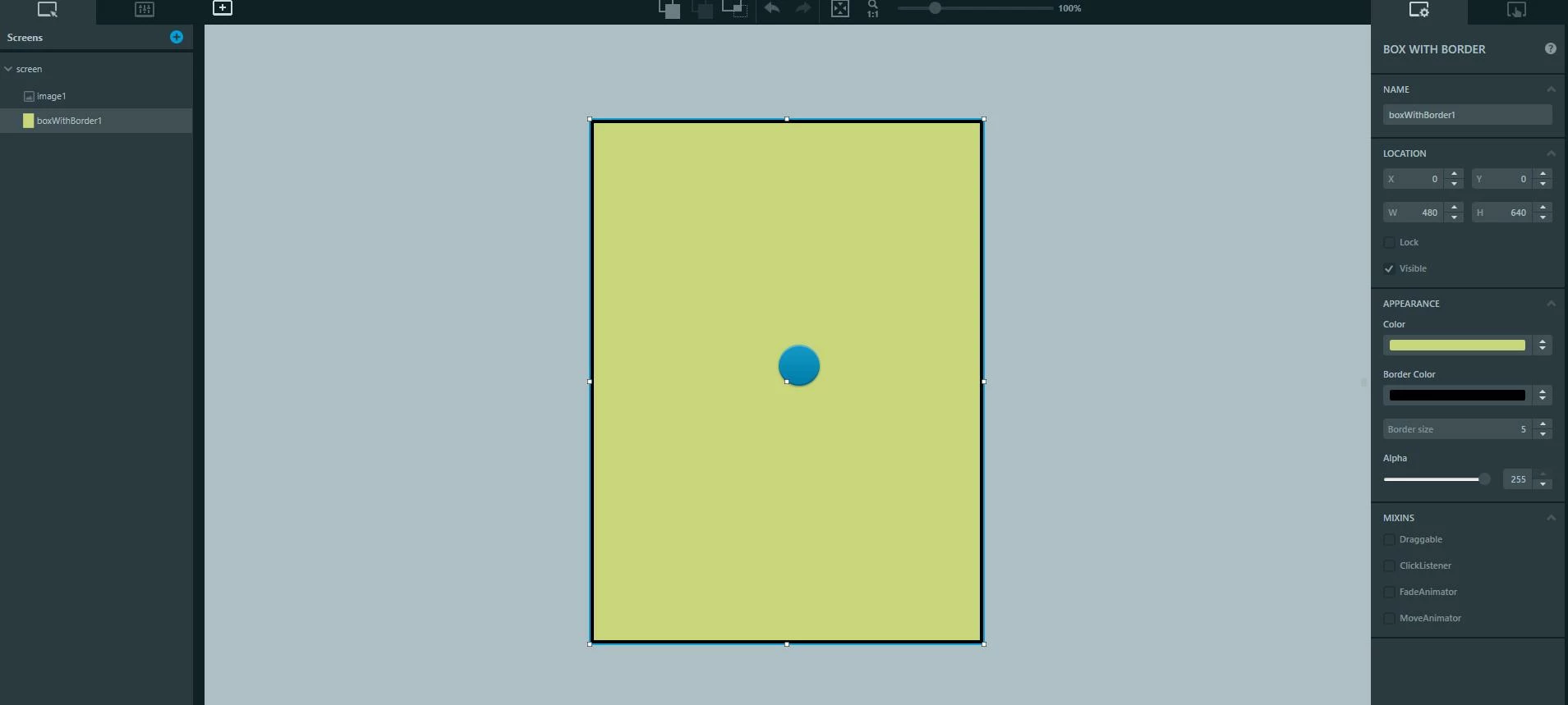

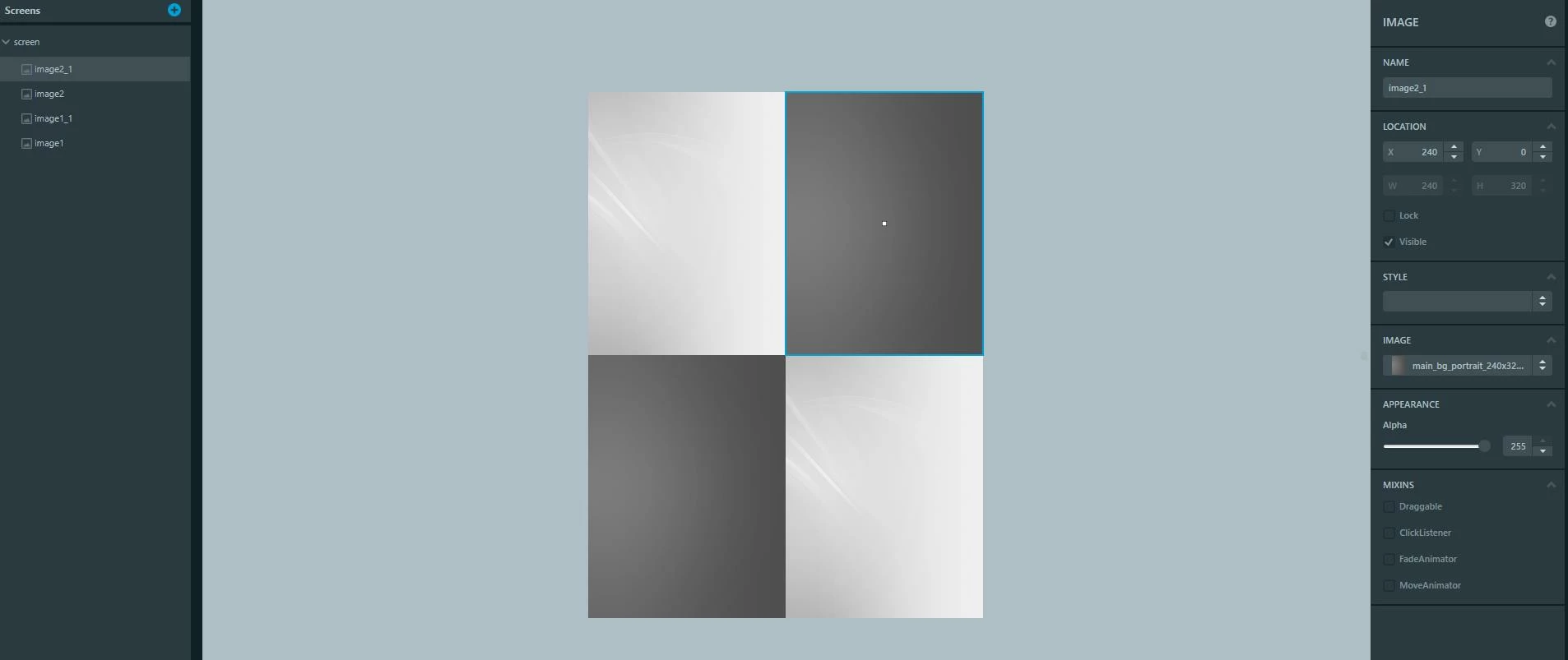

Hi, My project is base on STM32F469 ,LCD use DSI video mode.
Now I can show pixels in TouchGFX box , but can not show images.
Touchgfx project with images:0693W00000AMdJWQA1.jpg​
display like this:0693W00000AMcnBQAT.jpg​

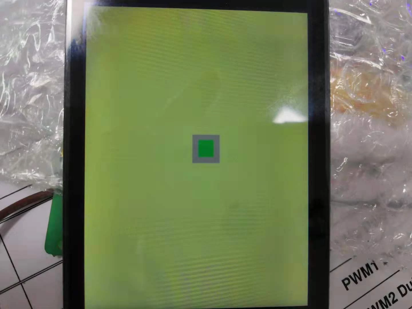

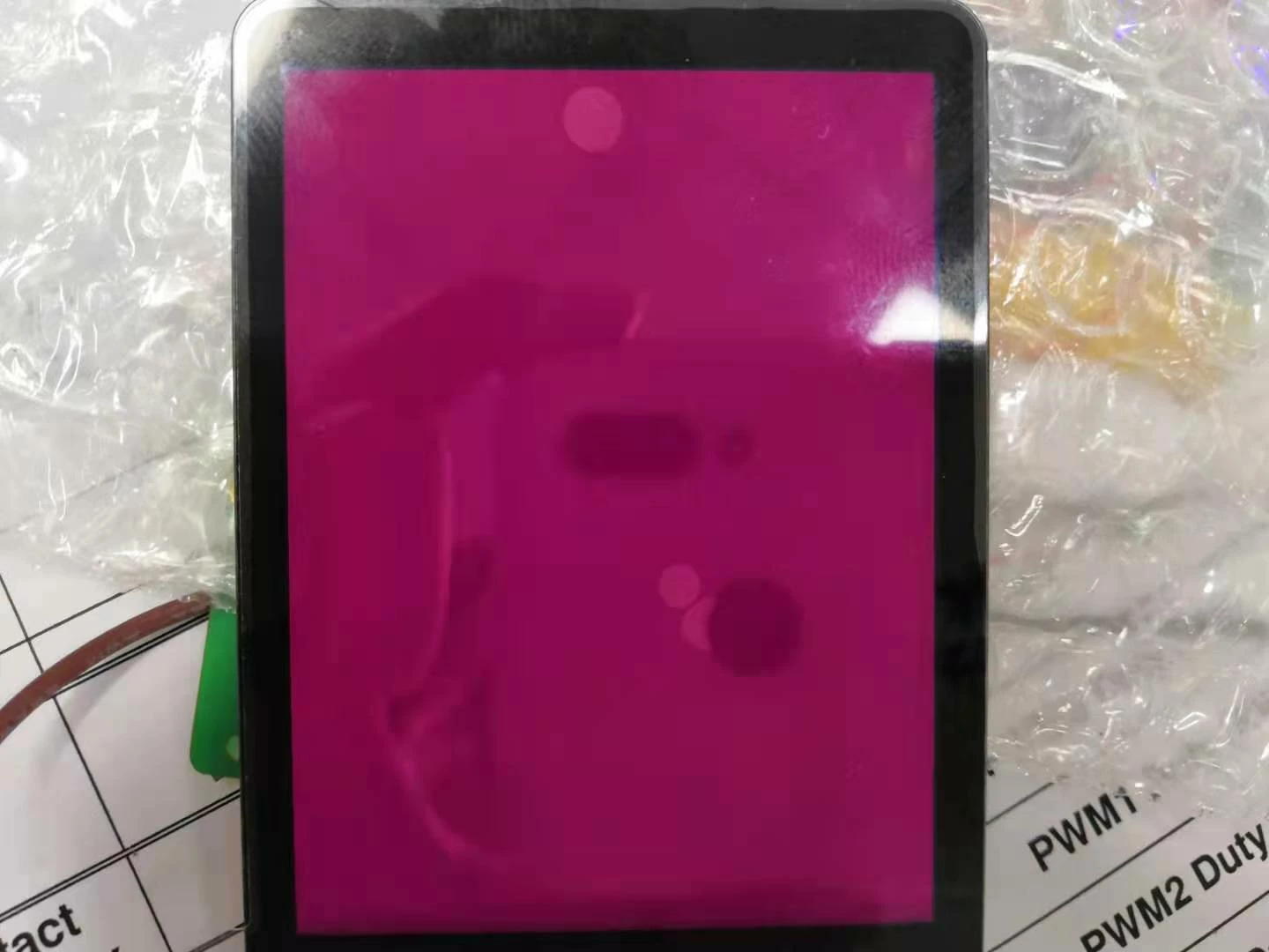

touchgfx project with image&pixel:0693W00000AMdNKQA1.jpg​
display like this:
0693W00000AMdPsQAL.jpg​

Best answer by Zbobo.1
Thanks everone. I found that qspiflash download FLM is not correct.When I erase flash it write 0x88 into it and touchgfx images always get 0x88...​
And my QSPI memory mapping mode is not setting correctly too.STM32F469-DISCO is use N25Q128A , my project is use W25Q128FV instead.

Hi MM..1
I had checked my driver and DSI , LTDC setting, is okay.Use HAL_SDRAM_Read_16b() to write Touchgfx image generated xxxbpp.cpp can get correct display.But image in touchgfx project cannot display correctly.
