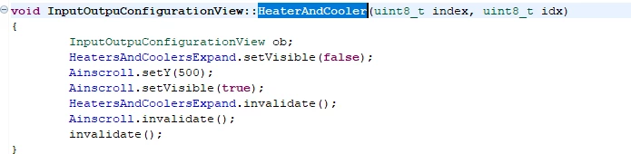

I've tried to do like this. Create a callback for button:
0693W00000aHNeuQAG.pngHere goes when callback gets call. And I create an object of other class to call function:
0693W00000aHNpAQAW.pngAnd goes to this function:
0693W00000aHNptQAG.pngThe problem with this method is that does not perform commands like "setXY" and etc. but only touchgfx_printf works. What I do wrong?

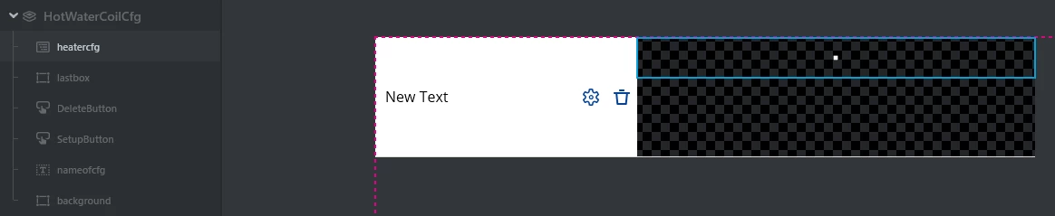

I've tried two methods. Pass index by pointer and by class.

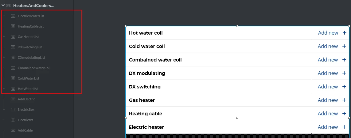

For better understanding what I want to do I try to explain. First of all in my view window is container and in that container I create a list using another container. On the left is my lists.
0693W00000aJIksQAG.pngThis is what I put in list and in this container I put another list:
0693W00000aJIlbQAG.png0693W00000aJIllQAG.pngSo here is "SelectController" button and for that I create callback and by click I get index of that button:

0693W00000aJImKQAW.pngAnd this is my function in my view window:
0693W00000aJImUQAW.pngProblem is that simulator crashes when I click SelectController button.0693W00000aJIn3QAG.pngAnother method that I tried to do pass index by function to call function in another class and it passes index but function like setY(), setVisible() does not work
