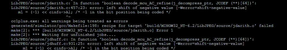

GFX's designer tell me that all warnings would be treated as errors.
But it's part of the LibJPG library, and I can't change it.
Is there any way to get rid of this "error"?
​I want to open a JPG image in the simulator and display it
Thank you very much, kind stranger.
Best answer by Martin KJELDSEN
Designer uses the makefile located in your application at simulator/gcc/Makefile.
You'll find a list of compiler flags here. Remove "error" to not treat warnings as errors.
