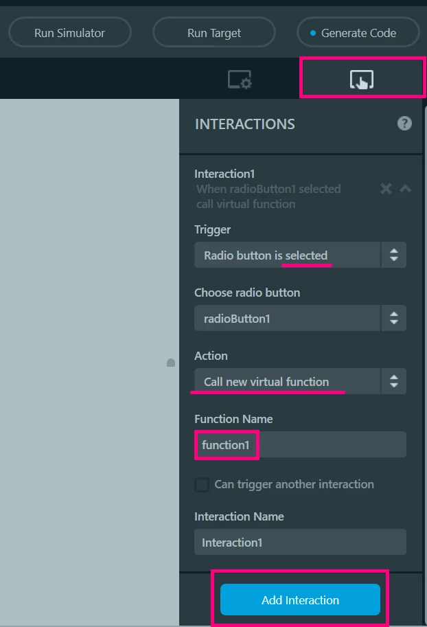

OK, it is probably a stupid question, but I'm no able to find a solution...
I need to call a function when a button is pressed, and a function when it is released.
I can handle pressed/released status by:
void Screen1View::handleClickEvent(const ClickEvent& event)
 if((event.getType() == ClickEvent::PRESSED))
 	Instruction1();
 	HAL_Delay(50);
if((event.getType() == ClickEvent::RELEASED))
	Instruction2();
	HAL_Delay(50);
but this is called every time I touch/release the screen and not the single button.
If I use flexButtonCallbackHandler(),
void Screen1ViewBase::flexButtonCallbackHandler(const touchgfx::AbstractButtonContainer& src)
 if (&src == &Down_Button)
 //Interaction1
 //When Down_Button clicked call virtual function
 //Call function1
 Instruction1();
 HAL_Delay(50);
I can determine the button pressed, but I haven't a call when the button is released.
Any solution?
Thanks and best regards to all the community!

Hello @MM.22aino​,
I recommend you using a radio button, you add it in the GUI first, then create an interaction on the right section as presented in the photo attached.
In the menu, you can select "Radio button is selected" or " Radio button is deselected " as Trigger, then you have the action menu, you can either select one of the proposed options or select “Call new virtual function�? and develop it in the code generated by TouchGFX in the STM32CubeIDE.
Please note that the base files should not be modified since they are generated directly from the created interface and widgets.
Chahinez.
