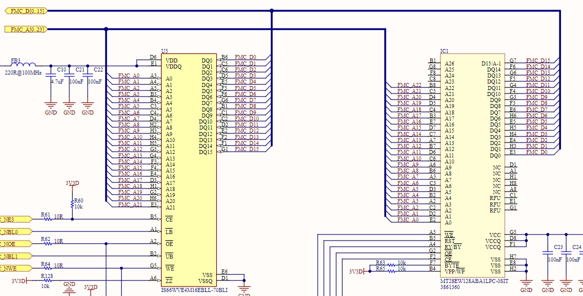

Hi, I'm trying to find adress space for not memory mapped 16MB NOR.
I have external PSRAM IS66WVE4M16EBLL + NOR MT28EW128ABA1LPC-0SIT with STM32H753ZIT6. They are both on the same bus:
FMC: NOR 0x60000000,PSRAM 0x68000000. Not using MPU. I use raw addresses of PSRAM as memory mapped, and HAL functions to transfer data to NOR. I tested memory integrity, R/W - all fine.

FBLBest answer
Sep 18, 2023 1:32 PM UTC
Hello @PAdam.11
You may need to check the definition of external NOR Flash memory in the linker script.
MEMORY
 EXT_NOR (xrw) : ORIGIN = 0x60000000, LENGTH = 16M
 EXT_PSRAM (rw) : ORIGIN = 0x68000000, LENGTH = 8M
In the article, assuming that you want to store your bitmaps in non-memory mapped flash. This can be e.g. USB storage, NAND flash etc. In your case, you are locating the bitmaps in memory mapped region!
You should place the external flash section which contains all the bitmaps into a virtual memory.
To give better visibility on the answered topics, please click on "Best answer" on the reply which solved your issue or answered your question.Best regards,FBL
