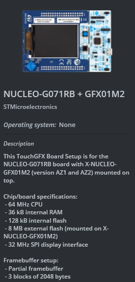

When I create a gauge with this configuration, it works fine in the simulator, but on the device the needle is not visible.
Arcs work fine, and gauge is correctly displayed. Needle is not.
I have tried with STM32F746G-DISCO: it works fine.
It's only with nucleo-G071RB + GFX01M2.
My environment:
- nucleo-G071RB board
- X-NUCLEO-GFX01M2 espansion board (XNGFX01M2$AZ1)

Unfortunately, G071RB is not graphically strong enough to handle Texture Mapper animations. That's why the needle is not shown, it is not a bug.
Good luck, don't hesitate to ask more questions

Yes, if you want such animations you should consider a board from H7 or F7 family
