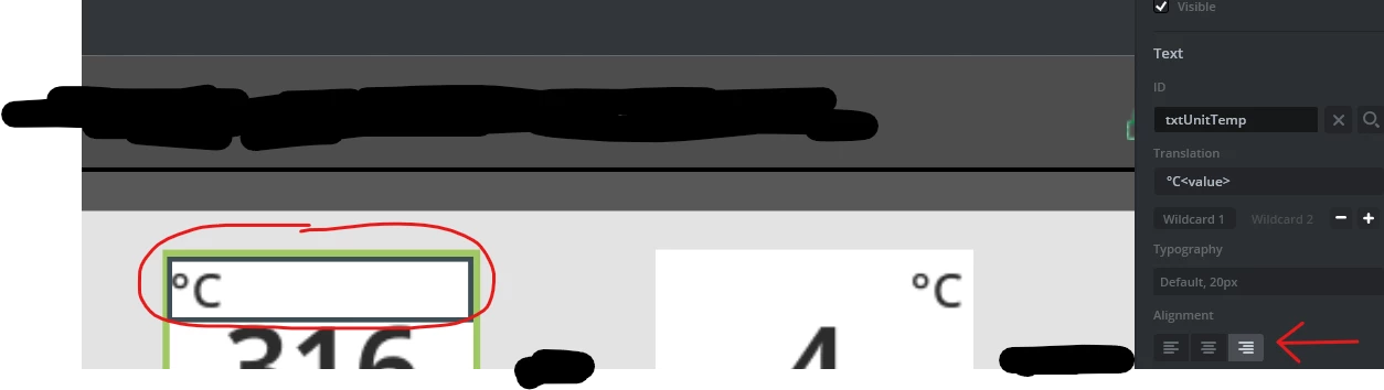

Bug: text alignment in TouchGFX designer does not update when assigning textID
TouchGFX 4.26.0
Low severity bug. Only visual in Designer. In the generated code the correct alignment is used.
Steps to reproduce:
  1. create TextArea.
  2. Disable “auto-size”
  3. Set textID with text element that has right alignment.
  4. The shown alignment is still left aligned.
When Designer is restarted, the correct alignment is shown again.

Hello ​Aron.
Thank you for reporting the bug!
I will pass your request on to the TouchGFX Designer development team. However, I cannot guarantee that a fix will be included in the next release of TouchGFX.
I understand how annoying it is to have to restart TouchGFX Designer each time the bug occurs, but I found that it is actually sufficient to switch to another screen or container and then back again, rather than restarting TouchGFX Designer.
Best regards,
Johan

Hello ​@Aron Hoogeveen,
This issue has been fixed in the latest version of TouchGFX 4.27.0.
