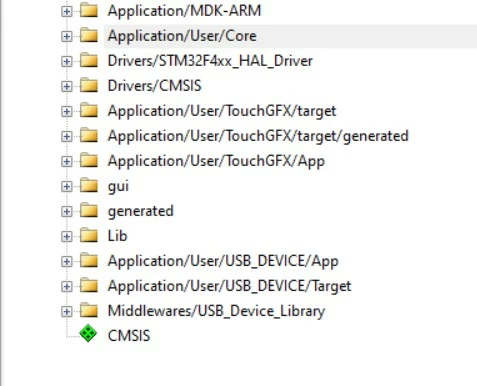

I dont know what is the problem, but when USB is configured in CDC mode in CUBEMX (maybe other modes also can generate the same problem, havent tested yet.) and the code is generated with CUBEMX, touchgfx code genereation will result in file omition from KEIL. There is no matter with STM32CUBEIDE since folders and files are not touched.

To reproduce the matter, first of all one most use keil 5.27 or above with stm32cubemx 6.0.0 and touchgfx 4.14.
Then one should produce project with stm32cubemx while usb in cdc mode and touch gfx is activated. Then generating the gui with touchgfx will remove usb cdc from project since both of them are under middleware folder. Then for fixing the issue one must regenerate the code with cubemx to solve ommition of USB_CDC middleware from project file.
The matter doesnt exist with cubeide since the files arent ommited from their directory.

I found that if I remove old generated files and regenerate the code with Cubemx 6.1.0 and Touchgfx 4.15, There will be two separate sections, one for USB and one for the graphic library which is desired since regeneration and recompilation of total code was really undesirable and took a long time.

December 14, 2020
Before the omission of old files and regeneration of code with Cubemx and Touchgfx designer, the library file was put into the USB device library folder, but after regeneration, it seems that the problem has been solved, don't know which version has solved it.
Now I ask if the problem is solved with CUBEIDE? The compilation fails in Cubeide while Touchgfx is added.
