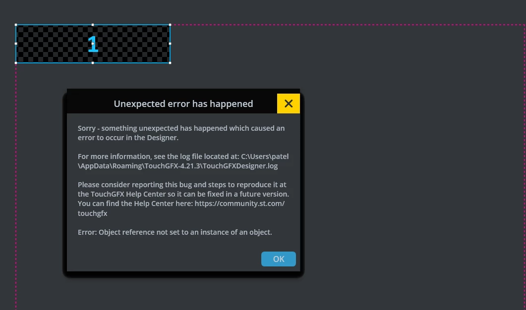

Bug Report: In container section
_legacyfs_online_stmicro_images_0693W00000biG6LQAU.pngWhen containers are copied within the software the touchgfx 4.21.3 crashes.
Log Outputs:
2023-04-17 15:50:37,616 [1] ERROR TouchGFXDesigner.App: Object reference not set to an instance of an object.
System.NullReferenceException: Object reference not set to an instance of an object.
  at TouchGFXDomainModel.Widgets.CustomContainerWidget.CustomContainerDefinition.get_Siblings()
  at History.Commands.MoveWidgetsInTreeCommand.CanMoveBackwardInList(IEnumerable`1 components)
  at MS.Internal.Commands.CommandHelpers.CanExecuteCommandSource(ICommandSource commandSource)

Yoann KLEIN
Apr 19, 2023 1:39 PM UTC
Hello @Community member​,
I'm not able to reproduce your issue, does it simply happen when you copy paste a custom container ?
/Yoann
Yoann KLEINST Software Developer | TouchGFX
PPate.9
PPate.9Author
Apr 24, 2023 3:06 PM UTC
Hello @Yoann KLEIN​
Yes. To reproduce the issue copy a custom container and paste the custom container into the container section to make a copy. Once you make any changes in the copied container the software crashes with this error.
It is not project specific. I am able to reproduce this issue in a new project also.
Yoann KLEIN
Yoann KLEINBest answer
Apr 25, 2023 7:25 AM UTC
Thanks,
I'm finally able to reproduce it. That's definitely a bug, I'll report it to my colleagues.
/Yoann

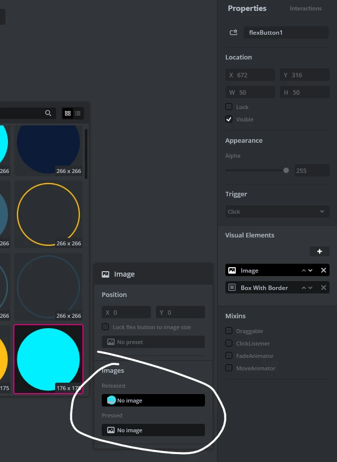

There is another bug in version 4.21.3. Sorry for not creating another thread.
Bug: Flex Button
When you add a Flex Button to the project and try adding an image in the visual elements, it doesn't register the selected image. I hope the screenshot helps to understand the issue.
Senior II
Apr 25, 2023 6:26 AM UTC
I also had the joy with this FlexButton image bug! Fortunately I had the "correct" FlexButton on another screen and could copy it. This must be a "new" bug, as it worked in older versions.
When this account seems to be inactive, try @tdecker2 - ST can't change mail addresses, so I had to create a new account.
Yoann KLEIN
Apr 25, 2023 7:26 AM UTC
We are already aware of those issues with the FlexButton. It's indeed something new, and we'll try to fix for TouchGFX v4.21.4.
Thanks for reporting though :)
/Yoann
