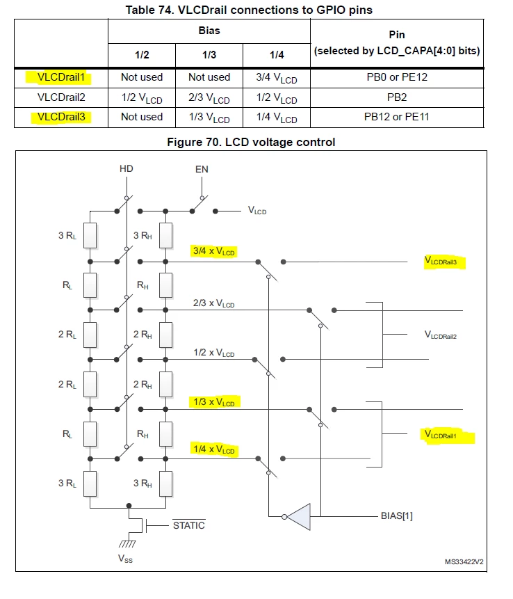

I've found an error in RM0367 revision 6 (STM32L0x3 Reference manual).
Please see attachment. As you can see, the VLCD rail numbering in Table 74 does not match the Figure 70.

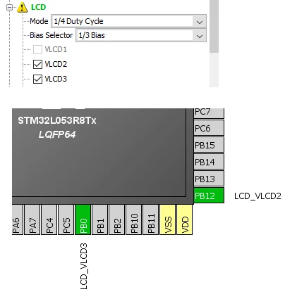

CubeMX software (V4.23) also has a bug in Bias selector due to discrepancy in documentation.
In case of 1/3 BIAS CubeMX configures PB0 and PB12 pins as VLCD rails instead of PB2 and PB12.
In case of 1/2 BIAS CubeMX configures PB12 instead of PB2.
#lcd #cubemx #stm32l0

Posted on January 03, 2018 at 09:32
Hello
Karsakbayev.Alexande
Thank you for your reported issue.This is raised internally to the appropriate teams.

Posted on February 20, 2018 at 11:31
Hello
A correction will be available in the next realease of RM0367 (Rev 7).
However, I can't give you any delivery date for the moment.
Sorry for the inconvenience it may cause.
