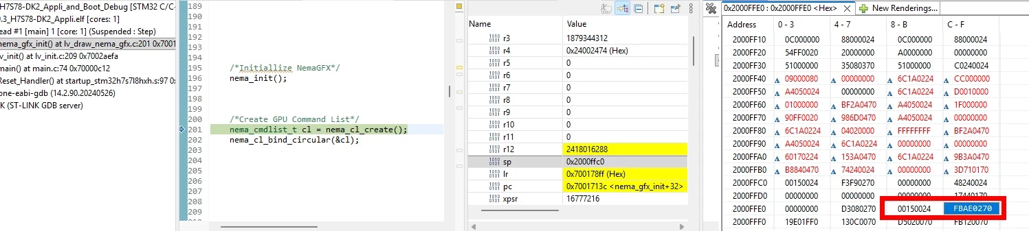

Hello.
I try to get the nema-gfx working on a STM32H7S78-DK.
But there's a bug in the NEMA library, or a bug in the ST toolchain.
When I try to call the library function nema_cl_create() in my function nema_gfx_init(), according to the STM32H7RS GPU2D document (page 6), stm32h7rs-system-gpu2d.pdf

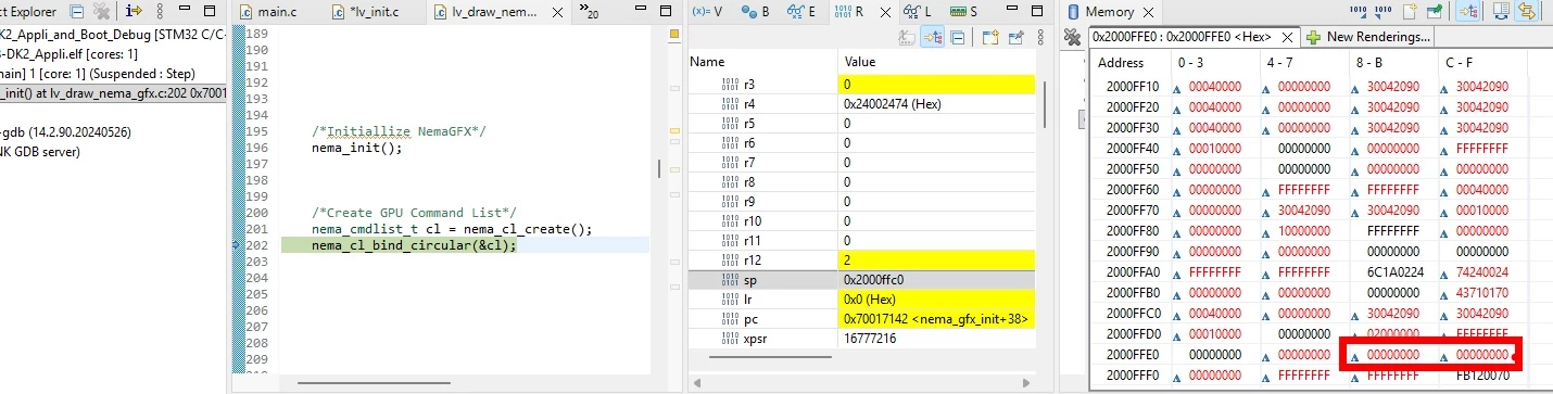

the stack is overwritten with values, so the return address on stack (0x7002AEFB) is no longer available (0x00000000) and the cpu goes in hard fault.
I suspect it's a bug in the NEMA library.
The correct version for the H7 series was used.
The error occurs with both versions: libnemagfx-float-abi-hard.a and libnemagfx.a.

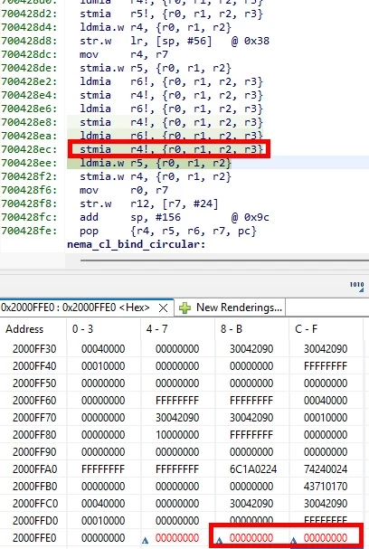

I looked inside the function in the disassembler, and at the end of the function, registers r0-r3 are written to the stack, but much too far! (See images)
Stack bevore calling nema_cl_create. Return-adress: okStack bevore calling nema_cl_create. Return-adress: ok
Stack after calling nema_cl_create. Return-adress: 0x00000000Stack after calling nema_cl_create. Return-adress: 0x00000000
Dissass. inside der nema_cl_create: overwriting behind actual stack endDissass. inside der nema_cl_create: overwriting behind actual stack end
The library is integrated into the STM32CubeIDE as usual via Settings -> MCU/MPU GCC Linker -> Libraries.
Are there any additional settings required for the libraries in the STM32CubeIDE project to prevent the stack from being overwritten?

Dec 1, 2025 9:46 AM UTC
Hi @Heinz_Baumer
Yes it sounds like something is wrong, but I expect an error in the setup.
To help I need to know what your setup is.
I suspect an issue in the nema_hal.c configuration that links the library to the hardware and memory.
I suggest you get inspiration from the configuration you get when generating an STM32H7S78-DK app using TouchGFX designer.
Special attention to the content of nema_sys_init(), compare that with the TouchGFX application (C:\TouchGFXProjects\MyApplication\Appli\TouchGFX\target\generated\nema_hal.c).
Alternatively, if you have access to NeoChromSDK for the H7RS platform you will have another but also working configuration. Look for the file nema_hal_freertos.c.
If your problems persist let's take it from there.

Hello.
nema_cl_create_sized(1024) helps a bit, but there are still problems with the Nema-GFX.
Is there any way to get the NeoChromSDK with examples for my STM32H7S78-DK?
It's not in the ST download section for STM32H7S78, and there's no information on where to get it.
