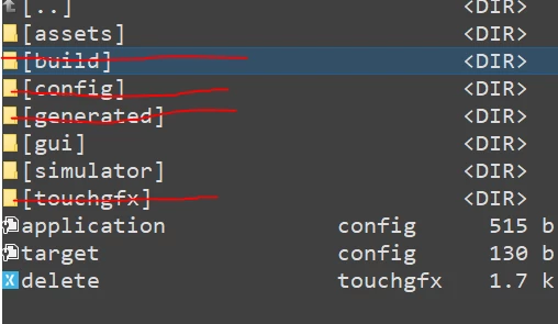

Hi, I will try deleting those directories. Build, config and generated are all inside the touchgfx folder so I assume deleting touchgfx is sufficient? If that is so does touchgfx need to be present on source control?
If that does not work I will cut down the project to supply it to demonstrate.
ferro
Lead
Jul 3, 2024 1:47 PM UTC
Delete these folders:
>" does touchgfx need to be present on source control?"
No it does not need to. When you run GfxDesigner build, 'touchgfx' folder is copied from c:\TouchGFX\ automaticaly.
