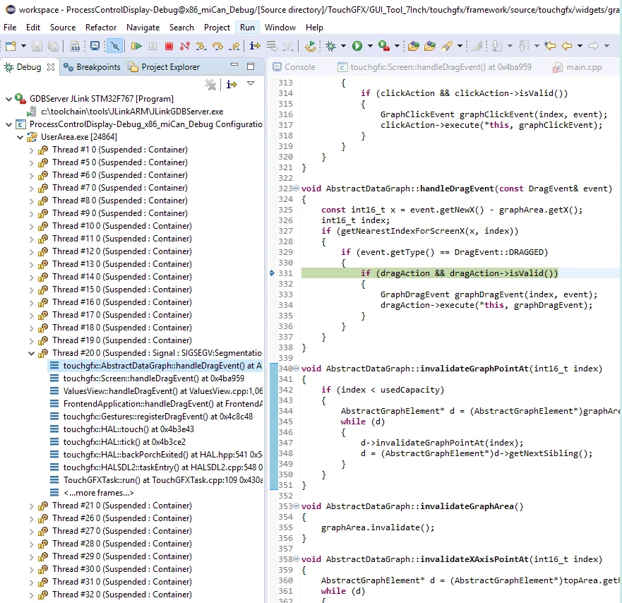

So far in AbstractDataGraph.cpp the library had:
namespace touchgfx
AbstractDataGraph::AbstractDataGraph(int16_t capacity)
 : dataScale(1), alpha(255), topPadding(0), leftPadding(0), rightPadding(0), bottomPadding(0),
 maxCapacity(capacity), usedCapacity(0), gapBeforeIndex(0), clickAction()
but it should be:
namespace touchgfx
 maxCapacity(capacity), usedCapacity(0), gapBeforeIndex(0), clickAction(), dragAction()
i.e. the problem was that "dragAction" was never initialized and our application would crash. But not every time you dragged a Graph widget, but only sometimes (when you enter that screen and everything is initialized for maybe the 2nd or 3rd time, then with the wrong garbage data, it would crash)
Here is our stacktrack where it would always crash. dragAction->isValid() would be called, even though dragAction was never initialized. i.e. you are dereferencing an invalid pointer. The reason why the "!dragAction" check passed, was because dragAction had garbage data (i.e. it was not set to nullptr upon initialization i.e. it was never initialized).

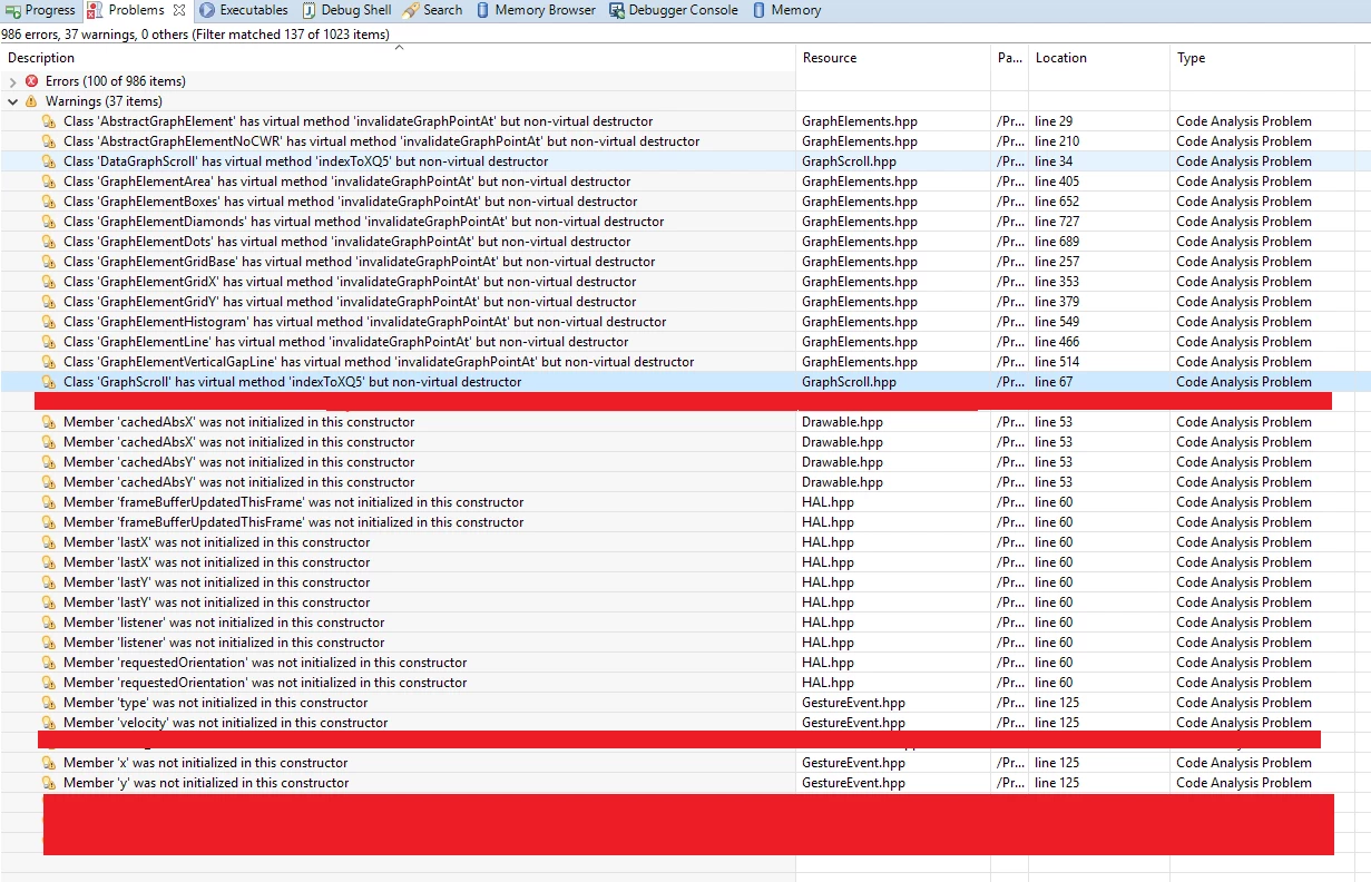

Also everywhere in this code, at least our linter, is saying there is no virtual destructor declared anywhere for any *Graph classes, but it has not caused trouble for us yet, so we have not done anything regarding this...
Soren Pingel DALSGAARD
Visitor II
Jan 20, 2021 11:07 AM UTC
Dear VSimu.1
Can you please be more specific. When I check the source code for TouchGFX I find that
class DataGraphWrapAndClear : public AbstractDataGraphWithY : public AbstractDataGraph : public Container : public Drawable which has a virtual destructor.
class GraphElementDots : public AbstractGraphElement : public CanvasWidget : public Widget : public Drawable which has a virtual destructor.
Since we might roll out a 4.16.1 soon, if you can be more specific, we might be able to look into this and include a fix in 4.16.1.
1) Which specific class is reported to have the problem?
2) Which linter are you using?
3) Are you actually casting a pointer to a base class before deleting it - otherwise it should not cause any problems. TouchGFX does not use dynamic allocation, so there is no problem there.
Thanks for taking the time to report these problems to us.
Regards,
Søren
VSimu.1
VSimu.1Author
Jan 20, 2021 12:45 PM UTC
Dear Søren,
Okay thank you for the information.
Answers to your questions:

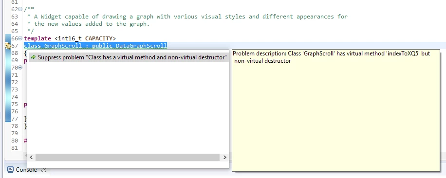

1) GraphScroll

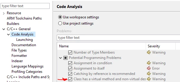

2) I do not know this. I do not even know where to find this. We use Eclipse and the code linter that checks the source files there shows this. See screenshot:
0693W000007BzwpQAC.pngTouchGFX only had "Warnings". Nothing was in "Errors" tab.
3) Okay. I do not think that we are for this case. But maybe that may change? We are also not dynamically allocating anything either, we are trying to avoid using "new" if possible.
