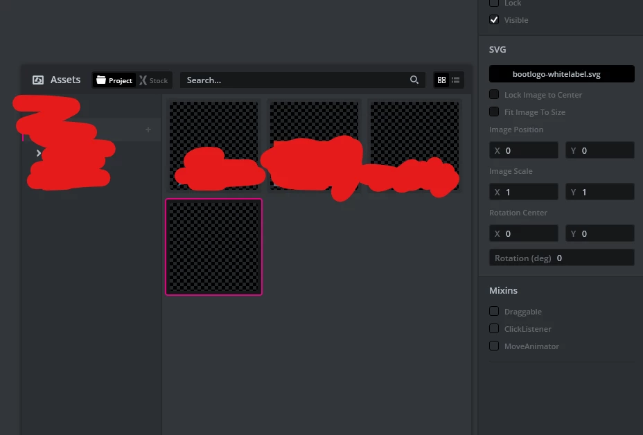

Given the following “empty” SVG file:
<?xml version="1.0" encoding="UTF-8" standalone="no"?>
<!-- Created with Inkscape (http://www.inkscape.org/) -->
<svg
width="1024"
height="600"
viewBox="0 0 1024 600"
version="1.1"
id="svg1"
xml:space="preserve"
xmlns="http://www.w3.org/2000/svg"
xmlns:svg="http://www.w3.org/2000/svg"
xmlns:rdf="http://www.w3.org/1999/02/22-rdf-syntax-ns#"
xmlns:cc="http://creativecommons.org/ns#"
xmlns:dc="http://purl.org/dc/elements/1.1/">
<rect x="0" y="0" width="1024" height="600" fill="none"/>
</svg>
I can select it as SVG file in Designer:

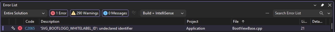

But sources do not get generated for the file. So when I try to build the simulator Build in Visual Studio I get the following error:

I believe this happens because no one ever considered the case of an empty SVG.
The TouchGFX generator primarily focuses on paths within the SVG - for example it also tries to eliminate empty paths and so on.
It is likely that it would not generate anything of no useful paths are found. As a workaround, you culd try to add a path to the image that is practically invisibe on the screen.
