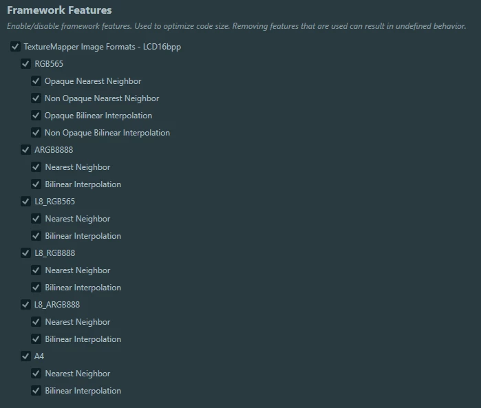

Analog Clock utilizes texture mappers for the hands.
But the G0 Application template disables the texture mapper by default for several reasons :
  • Reduces the memory footprint of TouchGFX lib (important with G0 since you have such a small amount)
  • Texture mappers are heavy load widgets that are not meant for low cost solutions (you combine both partial framebuffer and low performance MCU).
You can try re-enabling the texture mapper feature by opening your project in the Designer go to Config -> Framework Features
When enabled, you should see the following :
0693W000008ws4AQAQ.png/Alexandre
ALomb.1
Mar 15, 2021 7:33 AM UTC
Hello @Alexandre RENOUX​,
I have enabled the texture mapper. Flash occupancy increased by 50% (from 64k to around 96K) !!
However, the hands are not displayed.
I'm definitely not going to use widgets that require texture mapper on this hardware, but I wanted to point this out.
