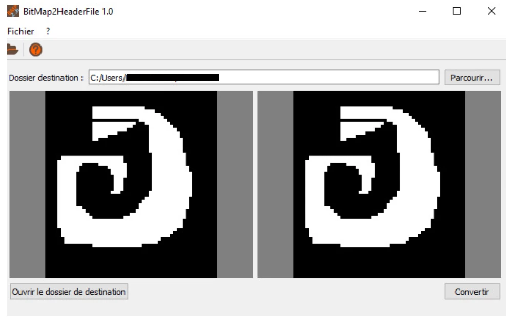

After search on net too much time, i found a software that
@sebastien Dumoulin (Community Member)​ made.
https://www.electro-info.ovh/bitmap2headerfile
He or she did really well program, but i have some problems with that.

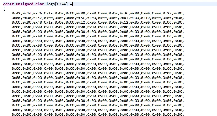

Software export (in pictures.h):
stm32f746g-disco BSP_LCD_DrawBitmap() function main.c:

Software with png:

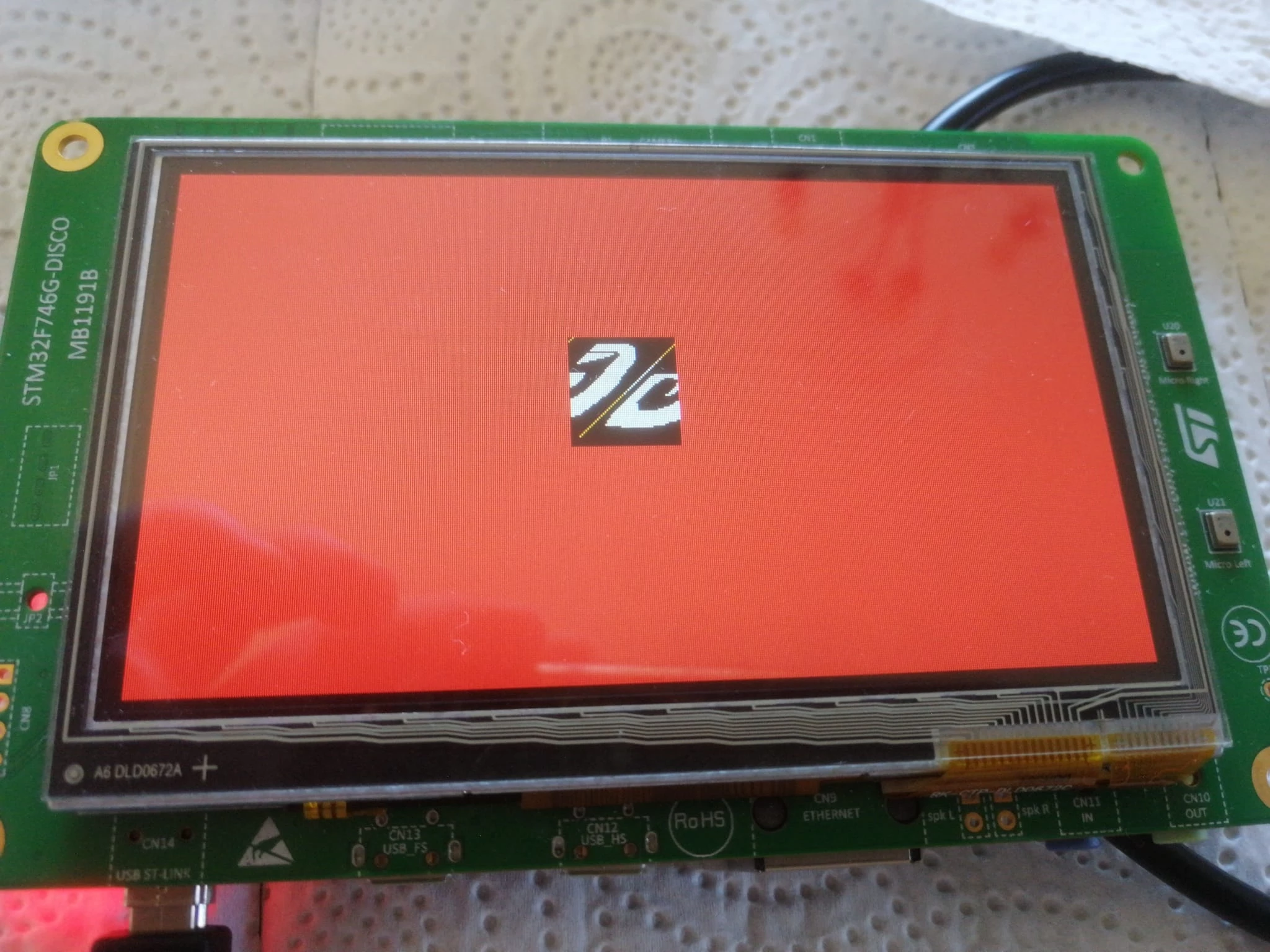

0693W00000QM5eiQAD.pngbut after upload to stm32f746g-disco showing on lcd this:
0693W00000QM4rWQAT.jpgProblems:
1)The picture started to drawing on half of the picture.
2)The picture slipped a little.
Do anyone have any opinion how to fix these ?
Software owner said that this program open source software. Could someone say how to change somethings in The software ?
Could someone recommend a program like this software that png to .h file with this format correctly ?

error is in last line, your used code is only for some sized images for example width 8 16 ... px
for universal you need correct code
Your logo width is 0x37 ...

It's designed to plot a simple line raster bitmap.
The raster length is wrong, the error accumulates with the line slipping further for each subsequent line.
Get some docs on the .PNG format, and understand it.
Might be easier to convert it to a simple raster format like .BMP, and then use THAT.
