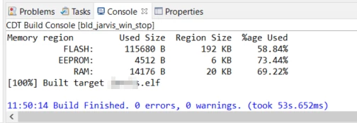

The bmp file size is 320x240x16K colors,
Compiling result :
0693W00000NphKrQAJ.pngany clues ?
Regards,

Andrew Neil
May 10, 2022 12:33 PM UTC
Again, what debugging have you done to find out what's going on?
"The bmp file size is 320x240x16K colors"
So have you done the basic maths?
320x240 = 76800 pixels.
For 16K colours, that must be at least 14 bits per pixel; presumably, you use 2 bytes?
So that's a total of 76800 x 2 = 153600 bytes = 150 K bytes for each file.
Are you trying to store all the files in memory at the same time?
