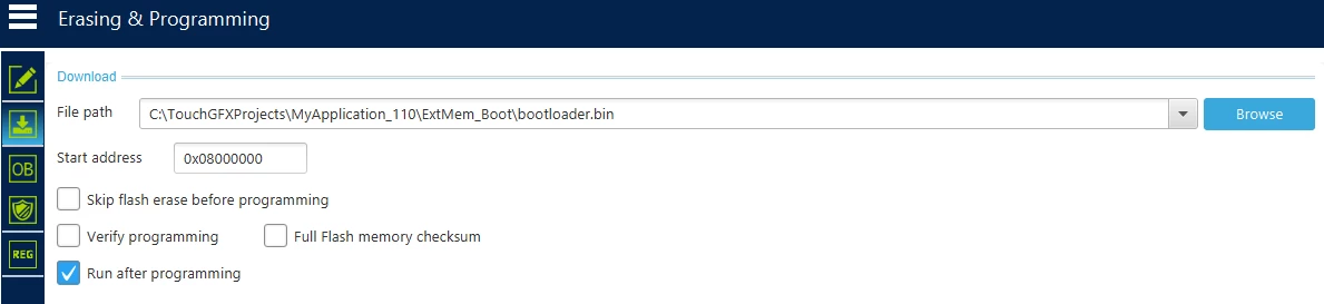

JohanAstrupBest answer
Feb 13, 2026 1:36 PM UTC
I am able to reproduce the issue now. It looks like the bootloader is not flashed when using Run Target. If so, that is an error. I will investigate further and get back to you.
In the meantime, you can fix it by manually flashing the bootloader with STM32CubeProgrammer, as shown below.
Best regards,
Johan

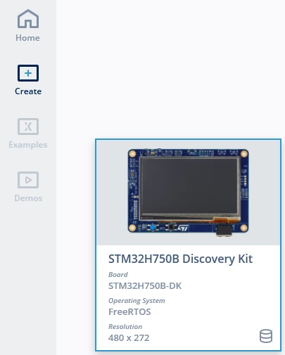

Feb 6, 2026 2:38 PM UTC
Hello @SivaVishnu09.
Could you try this procedure instead:
  1. Open TouchGFX Designer.
  2. Go to the 'Create' tab.
  3. Select the STM32H750B Discovery Kit TBS.
  4. Press the 'Create' button in bottom-right corner.
  5. Create a simple GUI (or import one).
  6. Press the 'Run Target' button (F6).
Best regards,
Johan

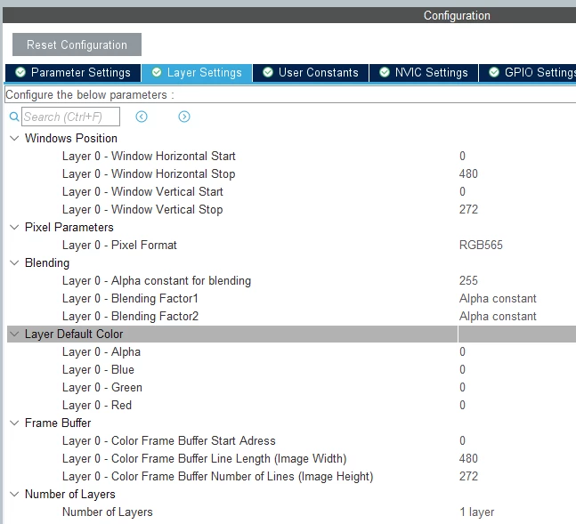

Hmm, okay that sounds weird then.
Could I get you to try and insert a box instead of an image?
If this does also not work, try changing the default layer color in the LTDC tab in STM32CubeMX, generate code, and flash the board again. This should help to verify throughput to the display. Also set the Window Horizontal Stop to e.g. 240. Otherwise TouchGFX's background box will overwrite the default layer color.
Best regards,
Johan
Best regards,
Johan
Feb 16, 2026 5:01 AM UTC
Hi John,
Thanks for letting me know about the bootloader programming! the program is working fine now. Thanks a lot!!!
Regards,
Sivapriya
