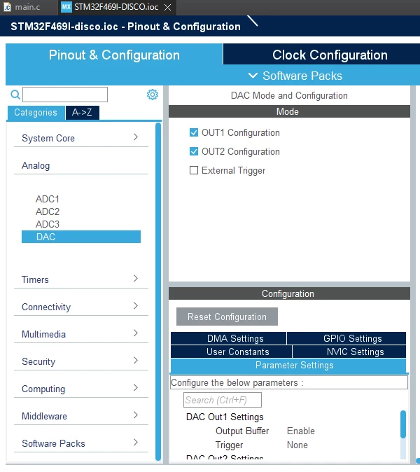

Black Screen on STM32F469I-DISCO with TouchGFX and DAC1 and DAC2 Enabled.
My STM32F469I-DISCO does not fully initialize when I enable DAC1 and DAC2 on a new TouchGFX 4.20.0 project.
0693W00000QKqqGQAT.pngIf I don't use TouchGFX, but just the latest version of STMCubeIDE (1.1) then everything works fine. What am I missing here? I've been able to use the DACs and TouchGFX on this development board in the past.

MM..1
Jul 11, 2022 4:37 PM UTC
Debug or compare generated code and locate diff or ... and latest IDE you mean 1.10.1
Kneepatch
KneepatchAuthorBest answer
Senior
Jul 16, 2022 5:19 PM UTC
Yes, latest IDE being 1.10.1.
Turns out that I didn't have enough heap and stack memory. Increased both and now I get DAC and the touchscreen. Thanks for your help!
