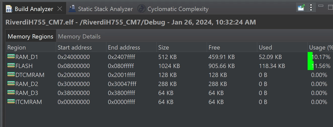

  • not using qspi and sdram just by using the 2 layer start address 0x20000000 and 0x20119400 for RGB888

Based on this image what should have been the proper framebuffer Starting address for the board?

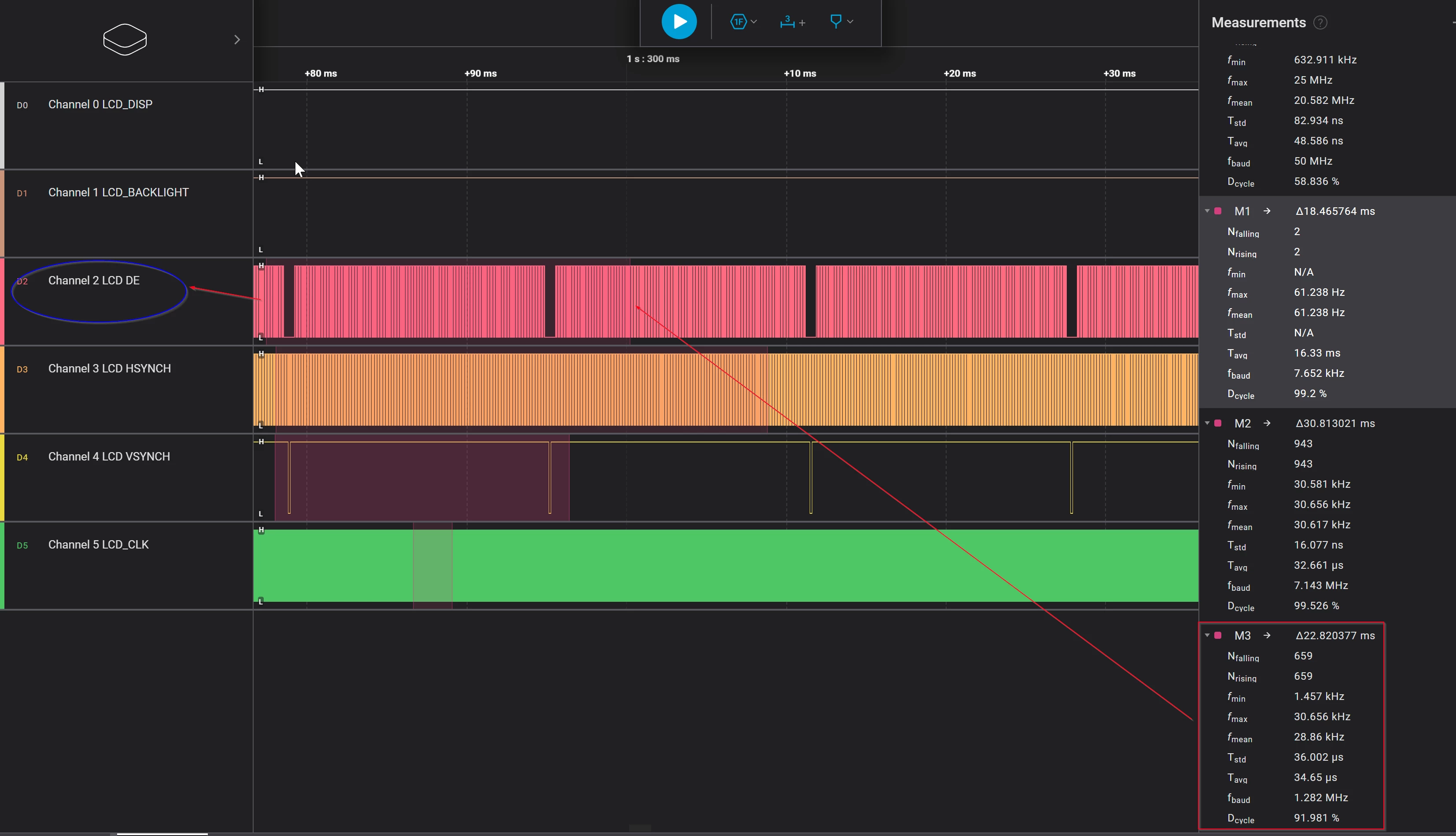

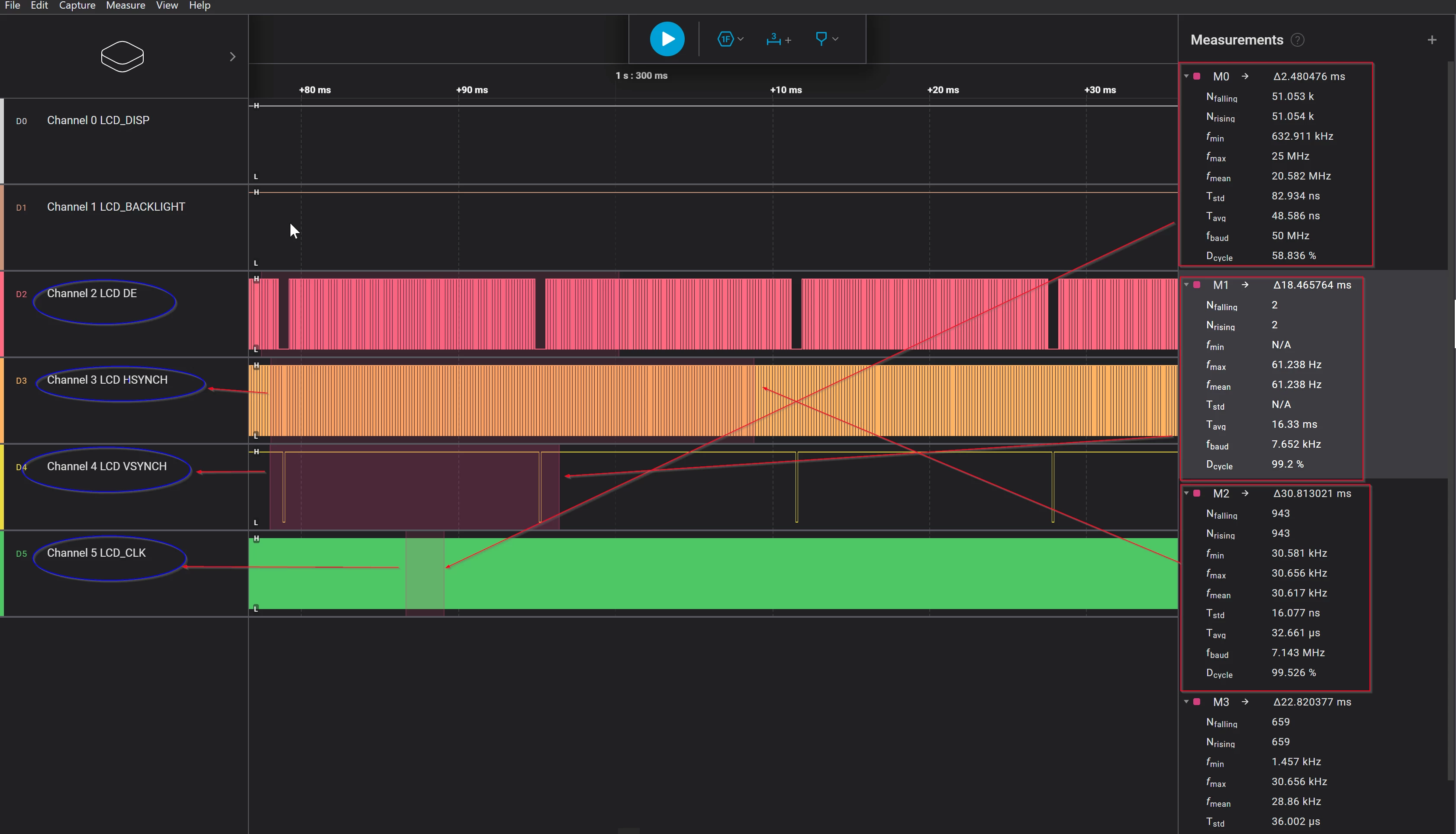

trying to check the pins:
