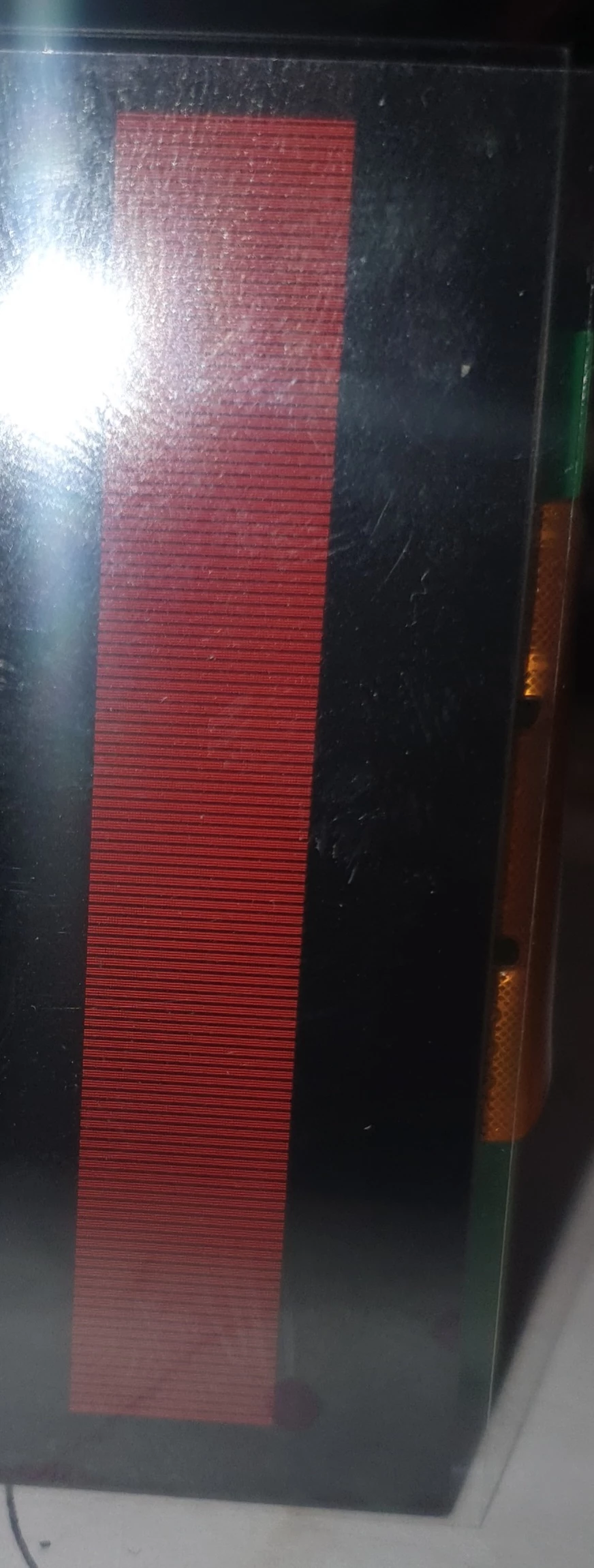

Black horizontal lines when SDRAM is used. Why?
another day, another problem...
I just started with a custom board. But i am using parts which are already working on boards from ST so i thought it will be easy to adapt.
I started a new project and if i use internal RAM for a touchgfx box everything is fine.
As soon as i add the SDRAM to the linker file i have a lot of lines (black or just not read from sdram correctly?).
For SDRAM the MT48LC4M32B2 with 16MB is used like in a lot of disco or eval boards.
MCU is running at 200MHz
My FMC / SDRAM Settings:

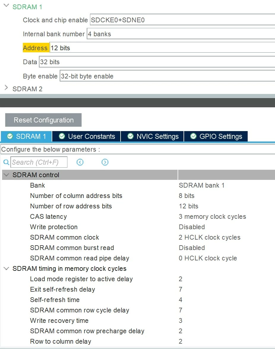

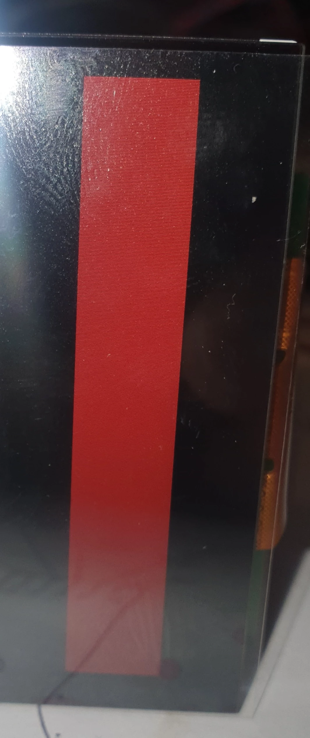

Here are the SDRAM Settings in MX and the pictures of the display with and without SDRAM active.
What did i forget?
Can it be a not proper soldered connection? Should this not end in a hardfault?
Thanks a lot for helping.

Feb 9, 2023 10:00 AM UTC
OK, this happens when not every connection between MCU and Flash is connected.
Reworked PCB and it works now.
In the unlikely event someone else has the same problem, check the connections

Jan 26, 2023 9:36 PM UTC
If the SDRAM isn't working properly you typically won't get a Hard Fault unless you executing code from it.
You could write and validate data patterns into the memory to confirm the read-back content is correct, and maintained over time.

Jan 26, 2023 11:01 PM UTC
Thanks for your answer.
I changed Data and Byte endable to 16 bit instead of 32 and now it is working.
But i expect a lower performance, right?
How can i validate the best way?
Read the 0xC0000000 in debug memory?
