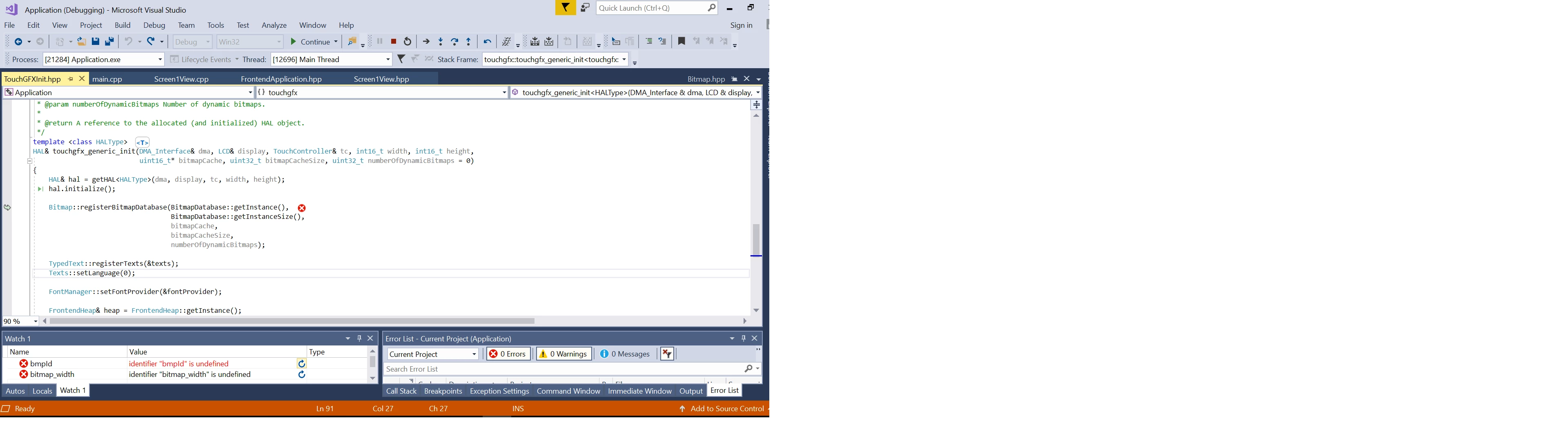

I'm trying to load jpeg files in TouchGFX by using the JPEG Loader Library. I have downloaded that from the Git using the link given in TouchGFX Forum. I have added the Library in my project and tried to load a jpeg image. The image was not loaded, the image is placed in the working folder alone. I have set the break point and checked if the file is opened successfully or not. The file was opened successfully but i didn't the image in simulator output . Suggest me a solution for this issue.

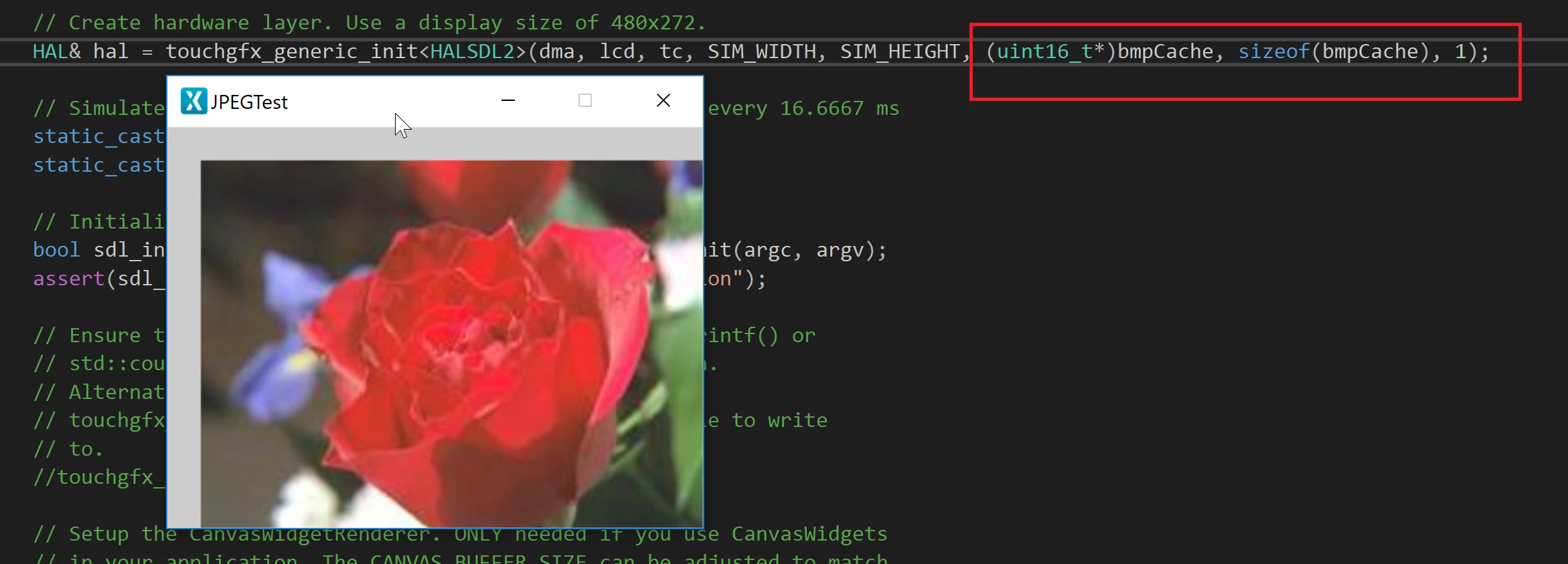

You're missing additional parameters to your touchgfx init call. Pointer to cache, size of cache and number of cached bitmaps. If you stepped through the code in your view you would have seen that a dynamic bitmap could not be allocated so the JPEG was never decoded.
Allocate your cache (e.g. in main.cpp) to be large enough to contain the image (240*320)
uint8_t bmpCache[240*320*4];

PBU
PBUAuthor
Feb 10, 2019 4:36 AM UTC
Hi Martin,
Thank you. It Works.

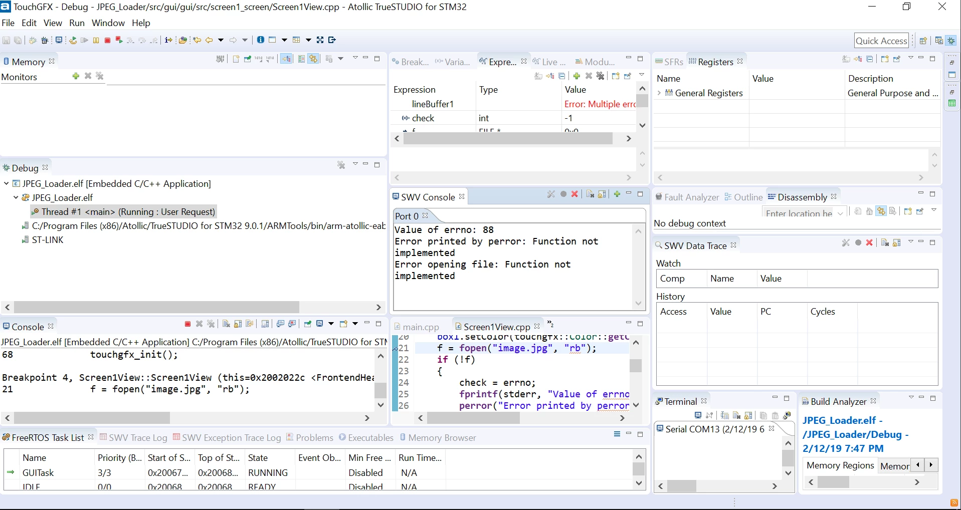

I have tried the same project using Atollic True Studio. The fopen return FAIL while trying to open .jpg file. Do we need to change any settings to solve this?
Martin KJELDSEN
Principal III
Feb 12, 2019 6:36 AM UTC
What does printing errno tell you from that failing call? #include <errno.h>
PBU
PBUAuthor
Feb 12, 2019 9:48 AM UTC
Hi Martin,
