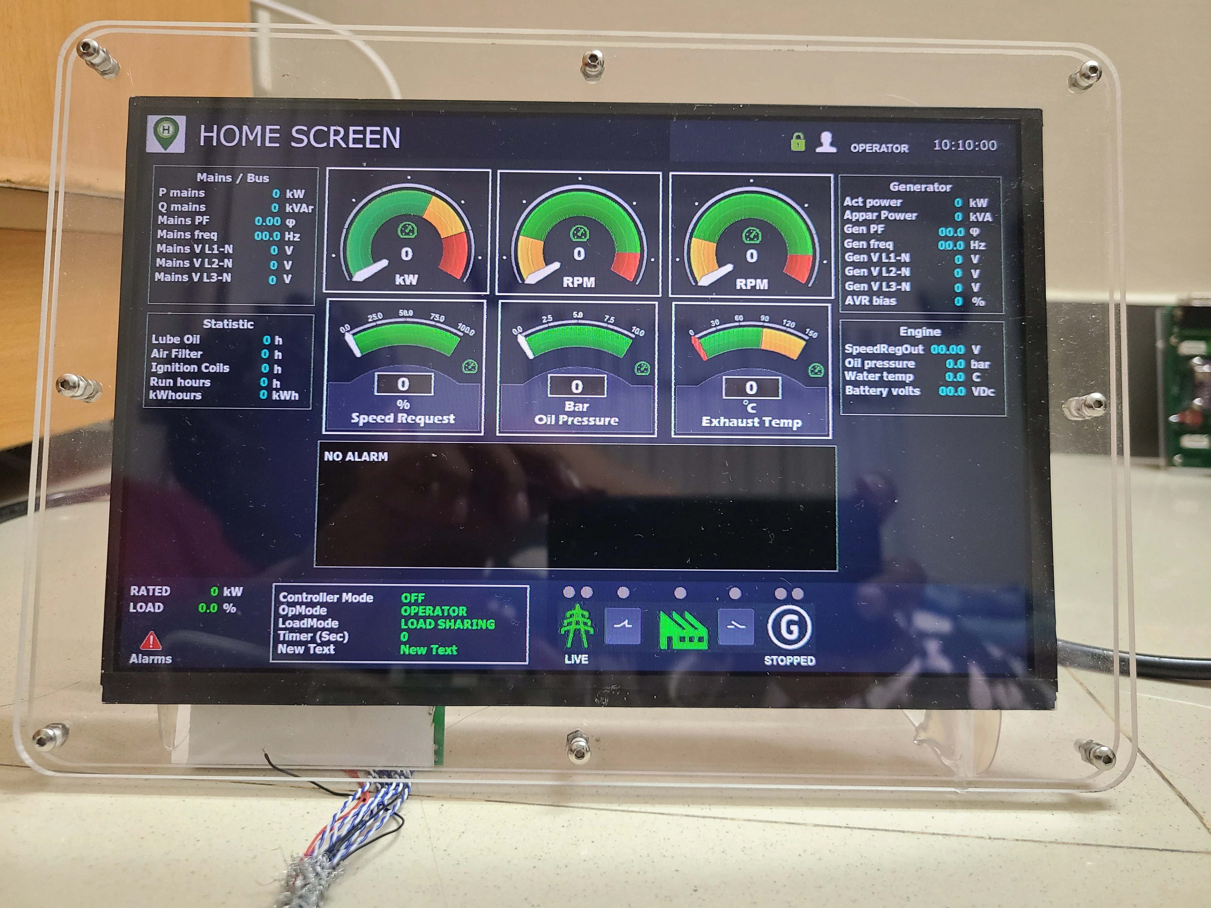

Here is my latest TouchGFX experiment on Samsung Tab 3 10.1" 1280x800 TFT.
I added 2 containers i-e Top_Bar & Bottom_Bar and I have 10 screens in this project with custom designed gauges.
