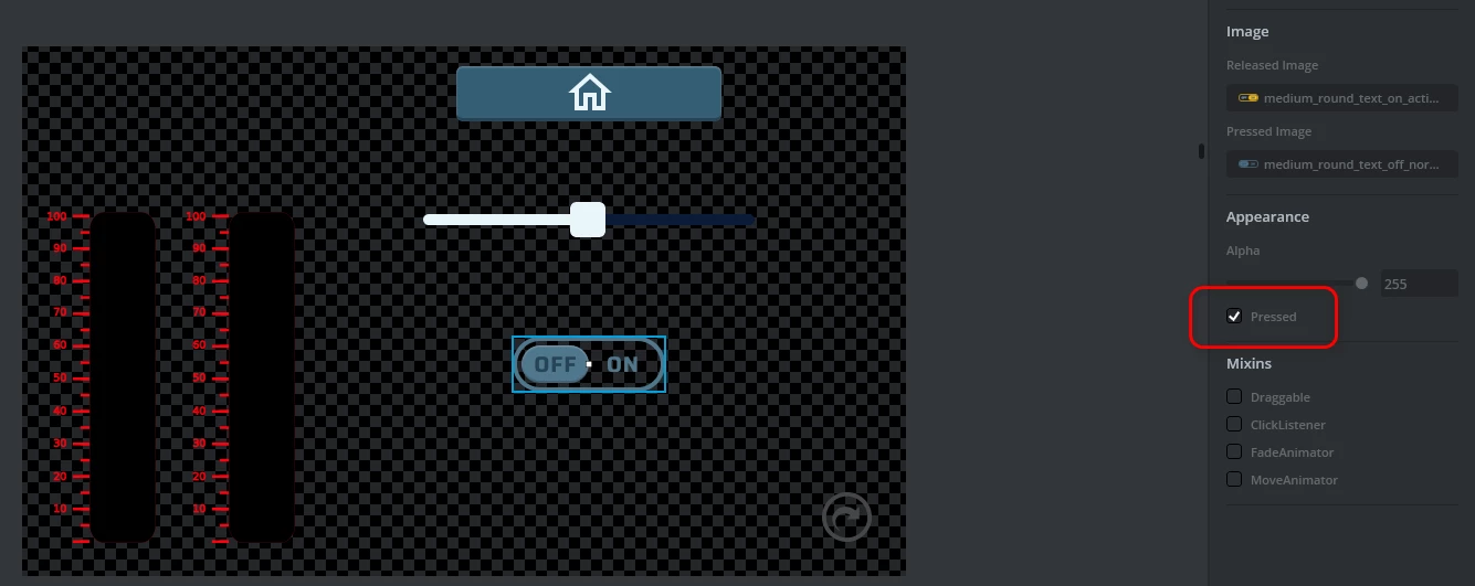

Visitor II
Feb 23, 2025 12:09 PM UTC
Hello TIF,
I also had this question at some point and resolved it by checking the box in the designer to set the state to "Pressed".  This is a bit confusing because in my mind I wanted the toggle to be off, and pressed implies on. (confused emoji)
