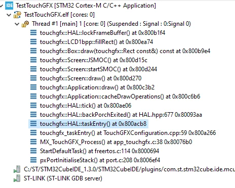

Yes i try to debugging! But is not simple to follow the code.
This is the call stack of the application when i pause it:

This is a 1bpp application? (LCD1).
Looks like its blocked trying to take a lock the farmebuffer.

It's not easy to tell unless i have your hardware. My first guess was that you've taken the lock in a custom widget without releasing it again, but i doubt that's it.
Are you calling HAL::getInstance()->lockFrameBuffer() at any point in time?

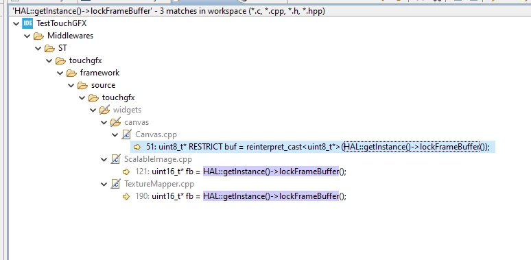

I know that it's not easy to tell me something, but i don't know how to search a solution!
I think that is not an hardware problem because i call the lcd controller routine only in the initialize method. I think, but maybe I can wrong, that is a software problem, maybe a wrong setting in the project.
It's possible to have a very basic workng project template that don't depend of the LCD hardware or microcontroller? Or if it's not possible, what steps I do (like write or override some methods) for having a working project?
I have searched HAL::getInstance()->lockFrameBuffer(), but I don't see any call to this function:
