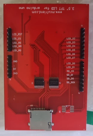

Hi, i am making a project with the ST NUCLEO F401Re using a TFT display of MCUFRIEND (not so good display), and the implementation is running with touchGFX 4.22.0.
The display works with data serial using 8 pins of data and 4 to control (just for context).

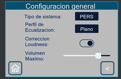

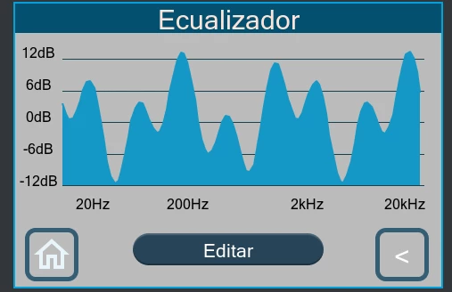

I have been making the entire UI and it works fine, but the problem is each time i need to swap from one screen to other, the refresh delays quite much in update all the screen (you can see the screen updating from top to buttom maybe like half second or less).
I am not sure but i think the problem might be my display.
For other side i noticed that if i am in one screen, and change widgets like buttoms, slider and so one the response is good and one cant notice the refresh.
Because i have the same background in all the screens (i attached the images of some of them) i was wondering if it is posible to not update the bockground but the widgets and texts only .
If someone have any idea or suggestion it will be very appriciate.
More info about the project:

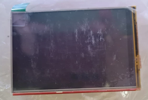

Display
I am using a TFT display of 3,5'' and 380x420 dimensions . The product was made by a company called "MCUFRIEND" and its a module with a touch screen, TFT displays and SD card slot (wich i am not using).
The display works with paralel 8 data pins, being the data format of 16 bits (most of the comands are 8 bits but to write on the display you send 16bits data).
To control the display i have been working with MCUFRIEND library which is used for many types of displays controlers. In my case i found that i my controler was an RM68140.
The touchscreen has a 4 wire controller, so it´s use 2 wires for each axes. For other side, the display also have 5 pins to control betwen comands and other kinds of data. Because the board use the same 4 pins to check the touch screen and controll the display, is necesary to make an multiplexation betwen each function. (I make it changing pins direction, readding the ADC to know the position press and going back to display control).
I addapted the code to works with my controller and only use the drivers functions that i need for my aplication (so i reduce code and ejecution times).
The drivers i use are the following (i only add waht i think is relevant code, but if you need all the code or another function tell me and i add the rest).
