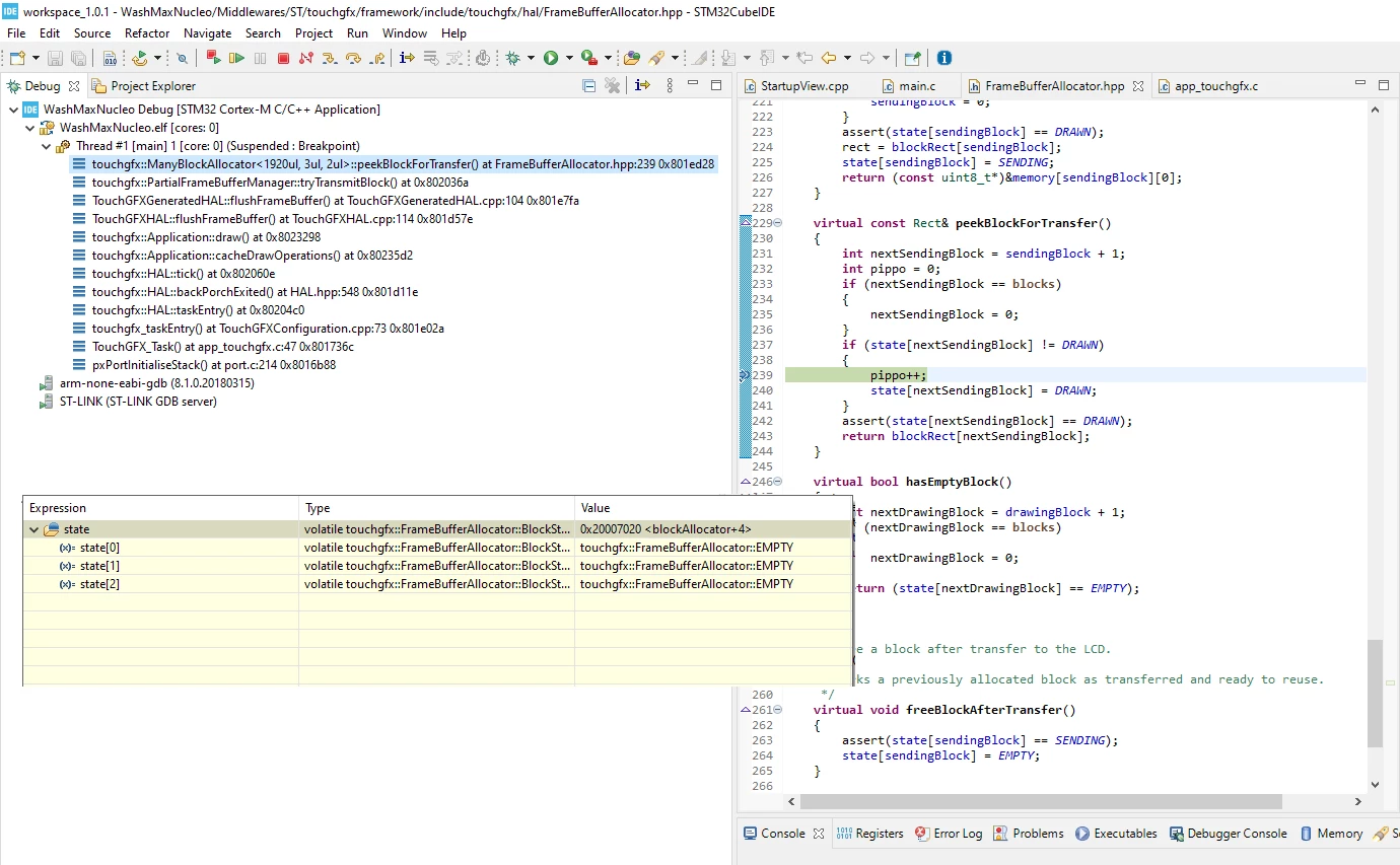

assert(state[nextSendingBlock] == DRAWN);
My HW is NUCLEO-F446RE and X-NUCLEO-GFX01M1.
TouchGFX is configured in partial frame buffer (3x1920 bytes)
In the project I use FreeRTOS API CMSIS V2.
The assert in question occurs randomly:
assertion "state[nextSendingBlock] == DRAWN" failed:
file "../Middlewares/ST/touchgfx/framework/include/touchgfx/hal/FrameBufferAllocator.hpp",
line 241,
function: const touchgfx::Rect& touchgfx::ManyBlockAllocator<block_size, blocks, bytes_pr_pixel>::peekBlockForTransfer()
[with long unsigned int block_size = 1920; long unsigned int blocks = 3; long unsigned int bytes_pr_pixel = 2]
When the assert occurs, the state fields are all EMPTY.

Hi Martin,
thanks for the support and I am sorry to take your precious time for 4.16.0 release which, of course, I am anxious to use ;)
The project is based on FreeRTOS (CubeIDE) and there are other tasks, in particular one dedicated to the transmission of messages via CAN BUS.
The problem occurs 90% of the time at startup and at the end of the animation. Consider that the animation is the same as the online demo for the NUCLEO-G071RB where I changed the images.
While waiting for the support I created the following workaround in Middlewares/ST/touchgfx/framework/include/touchgfx/hal/FrameBufferAllocator.hpp:
 virtual const Rect& peekBlockForTransfer()
 int nextSendingBlock = sendingBlock + 1;
 int foo = 0;
 if (nextSendingBlock == blocks)
 nextSendingBlock = 0;
 if (state[nextSendingBlock] != DRAWN)
 	foo++;
 	state[nextSendingBlock] = DRAWN;
 return blockRect[nextSendingBlock];
With this and with a breakpoint in "foo++" the execution with the debugger continues, but only if I break for a least three cycles. If I remove the breakpoint it crashes.
I am available for any clarification/detail you need.
/Antonello

Can you provide a stack trace when you hit the assert? This is to know if we are coming from the interrupt context.

ALomb
ALombAuthor
Senior
Jan 4, 2021 7:20 AM UTC
Hi and happy New Year !
@Flemming Gram CHRISTENSEN​  I have attached the image with the stack and the contents of the state vector.
Thanks
Martin KJELDSEN
Principal III
Jan 5, 2021 3:32 PM UTC
Thanks. We're trying to reproduce is here - This is not the first time we've heard about someone having issues with PFB and RTOS.
Martin KJELDSEN
Principal III
Jan 13, 2021 8:27 AM UTC
​Update:
We found a logic bug that would cause this issue. We have a fix ready for 4.16.1 which should be out end of January.
