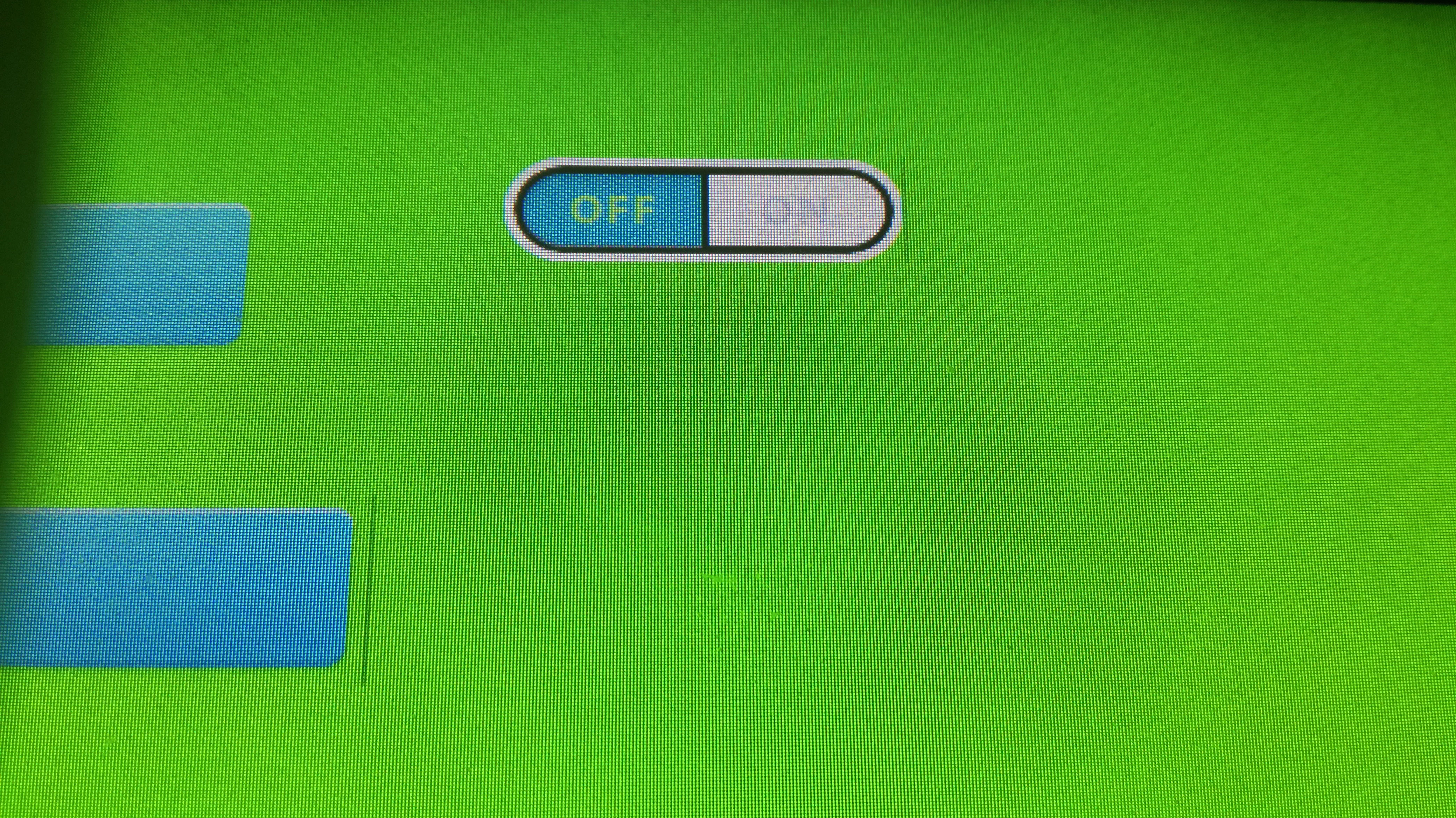

Hello! Look at the picture.
Artifacts - is lines at right side of widget
Can you say me possible course oth this artifacts?
I llok at memory window in KEIL - artifacts are in memory, is not LTDC artifacts0693W000000UpPMQA0.jpg

Is this your own custom platform with an H743 ?
/Martin
March 31, 2020
It is my own custom platform.
But it checked many times. Schematic is OK.
Signal Integrity is OK (SDRAM pseudorandom test - 10000 cycles without errors)
If I try to draw graphics without DMA - no artifacts. If I draw to SRAM - no artifacts
If I draw to SDRAM by DMA2D - I have artifacts.
Martin KJELDSEN
Principal III
April 1, 2020
Try calling
hal.lockDMAToFrontPorch(true);
This will make the DMA2D and LTDC NOT access SDRAM at the same time, so you can check for a possible memory contention / bus issue this way.
/Martin
April 1, 2020
I tried -without any effect.
I​ almost find..... If I delete nbl0,nbl1,nbl2,nbl3 from initialization - such artefacts appears on each widget and on both sides. I think, that problem is in these lines... but how to solve it....
Martin KJELDSEN
Principal III
April 30, 2020
What's your status on this? If you disable DMA - does the error still appear?
