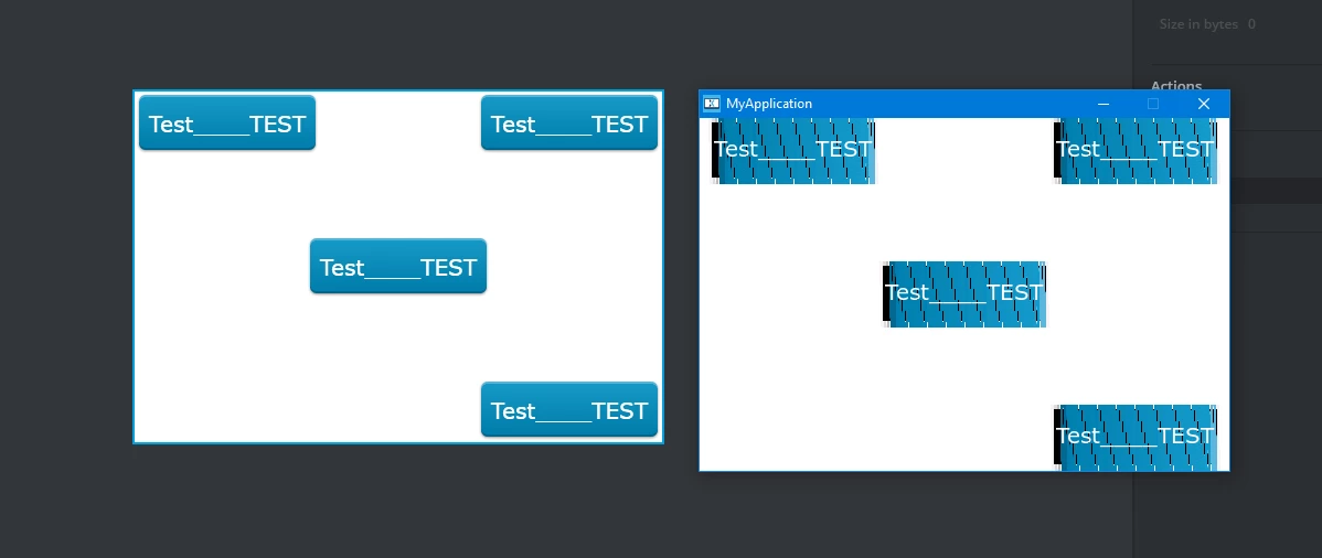

Hello everyone!
Faced an interesting problem.
When generating the TouchGFX code, strange artifacts began to appear on the display screen.
At first I decided that the problems were in the display driver. But then I looked through the memory and made sure that the problem was in the generated buffer.
Then, running the simulator in TouchGFX, I found that the problem is displayed there as well
I attach a screenshot of the designer and simulator
What could be the problem?

Know trouble you need set 90 angle images...
