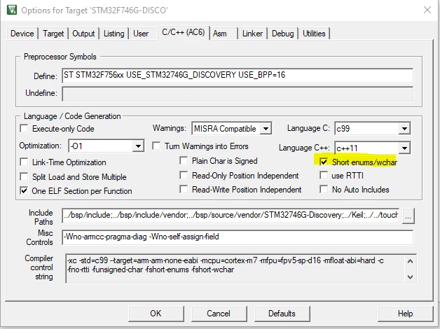

I created a new project from scratch (with the stm32f746-disco board)
and TouchGFX works fine with ARMCLANG, as long as you don't use the Middleware from Keil (at least the File System & USB libary).
Then linker error occurs.
I figured out that:
TouchGFX only links when "Short enums/wchar" is disabled
Middleware only links when "Short enums/wchar" is enabled
Keil mentioned : "The wchar_t type must be the same in all source and libraries to successfully link."
Can you build the library with "Short enums/wchar" enabled? This should fix the problem.
