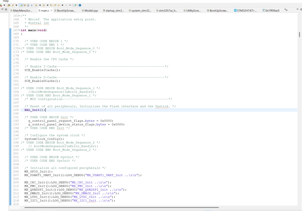

Thanks for quick reply, Yes there could be some trouble. Just for some more information. here are the OB settng from my cubeprogrammer and the Main.c function, this might give some more clue.
After power cycle, at least the debug log "MX_USART1_UART_Init" at line 207, should be received. I am not able to receive it as well.

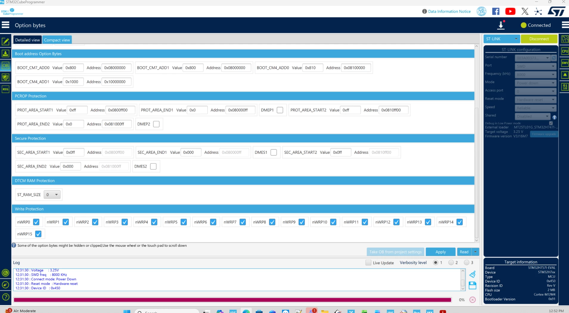

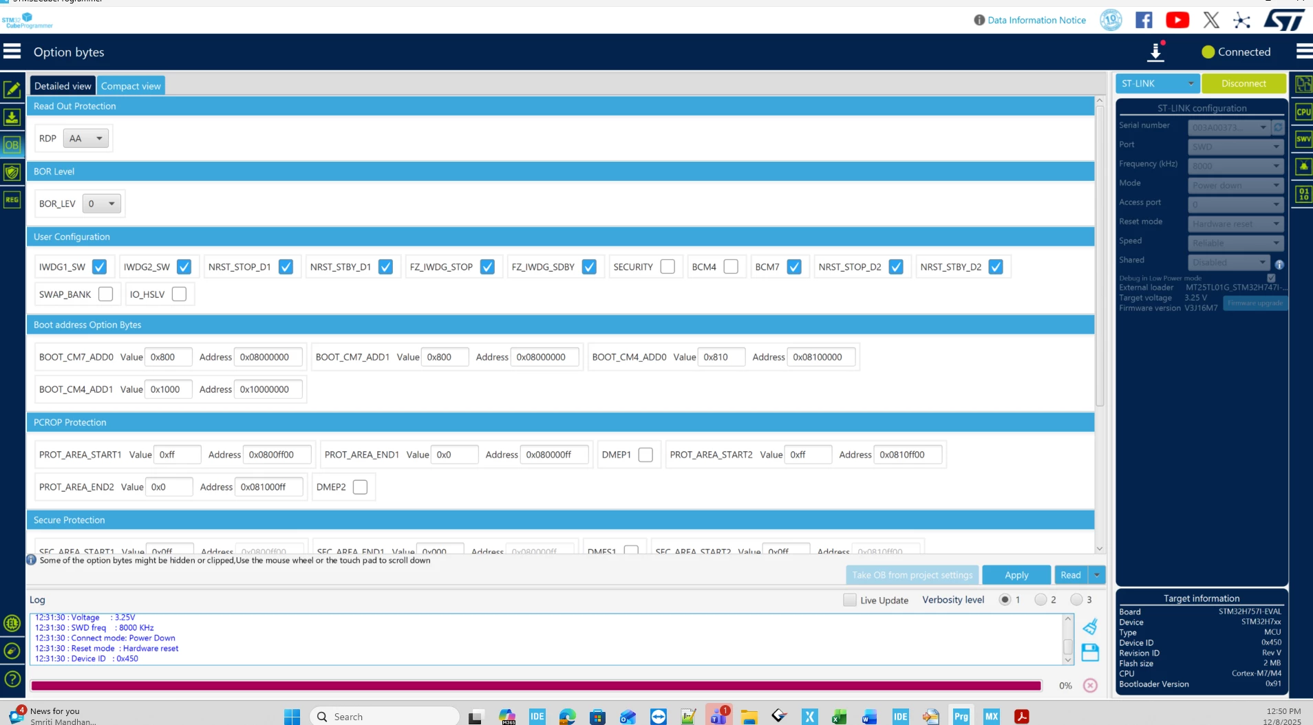

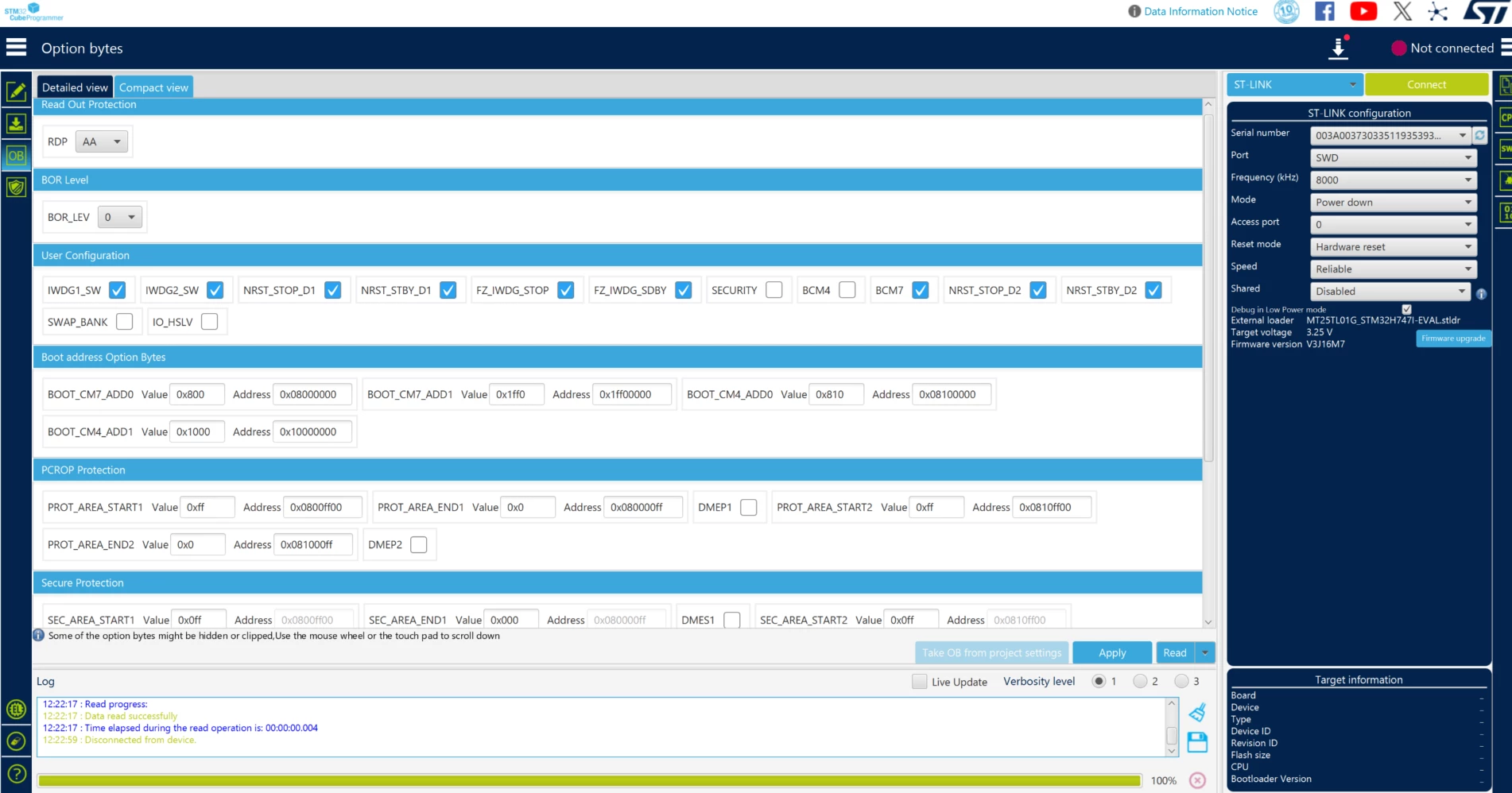

Yes agreed, such issue could happen because of the points you mention. Below are the responses might be this could give more clarity of issue. if you need any additional information then please let me know.
1. Verify the BOOT0/BOOT1 pins – make sure they are configured to boot from flash memory.
-> Yes the SW1 position is at FLASH, Pointing at 0.  BOOT0 Jumper is OPEN(no jumper connected, JP3).
2. Check the linker script – confirm that the application is being written to the correct flash start address.
-> Attached 2 files, this might provide clue, 1 is for the Flash.ld and other is for RAM.ld
3. Make sure Option Bytes are correct – especially the Read-Out protection and Write protection settings.
--> Attached below 2 images for the settings.
