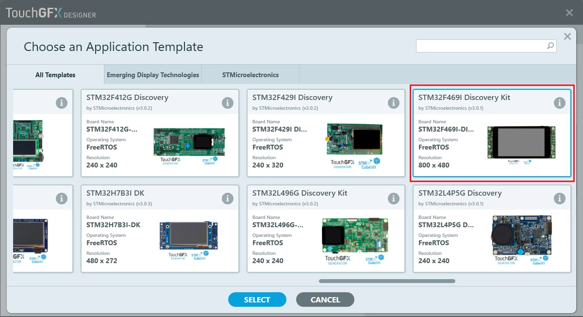

Best answer by N. SANTINI
Yes there are, do the following;
  • Open TouchGFX Designer, I use v.4.15 but v.4.14 should work too, however I encourage you to take the latest version
  • Create a new project and select the STM32F469-Discovery Application Template
  • Select a UI template or start from an empty one
  • click on "Create"
0693W000006EKe3QAG.pngThe default IDE is CubeIDE and is located at <your project>/STM32CubeIDE
Just launch CubeIDE and import the project from this location using "import existing project" option.
Then build and program once your board is plugged.
Best regards,
Nicolas

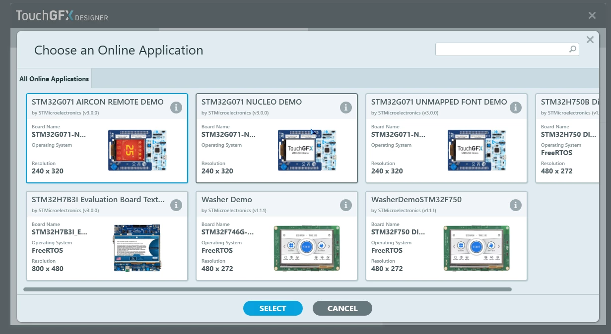

Hi Nicolas, I use TouchDesigner 4.16.1 (the lastest). It has very few projects, and none for the STM32F469I-Disco.
Are most Discovery boards no longer supported?
Romain DIELEMAN
June 7, 2021
You are looking at "Online Applications" which are board specific demos (we are changing the name in the next release of TouchGFX as the name is quite confusing). Have a look at the "My Application" tab instead and select the application template for the STM32F469I-Disco board. You will have multiple examples and demos under the "UI template" section.
/Romain

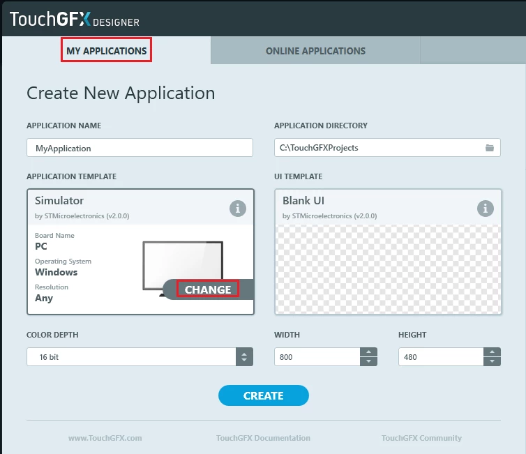

N. SANTINI
June 7, 2021
In the startup page you have two tabs "My applications" and "Online applications",
The "Online application" tab contains full applications dedicated to specific boards, usually because they require specific peripherals that are only present on the board (e.g. a joystick or a specific display type or definition) or require a specific amount of FLASH/RAM to run properly.
Instead, I suggest you to select the "My applications" tab and then change the application template:
0693W00000BaExwQAF.pngHere you will find the F469-Disco and almost all the other ST devkits.
Then select a UI Template or start from an empty,
Best regards,
