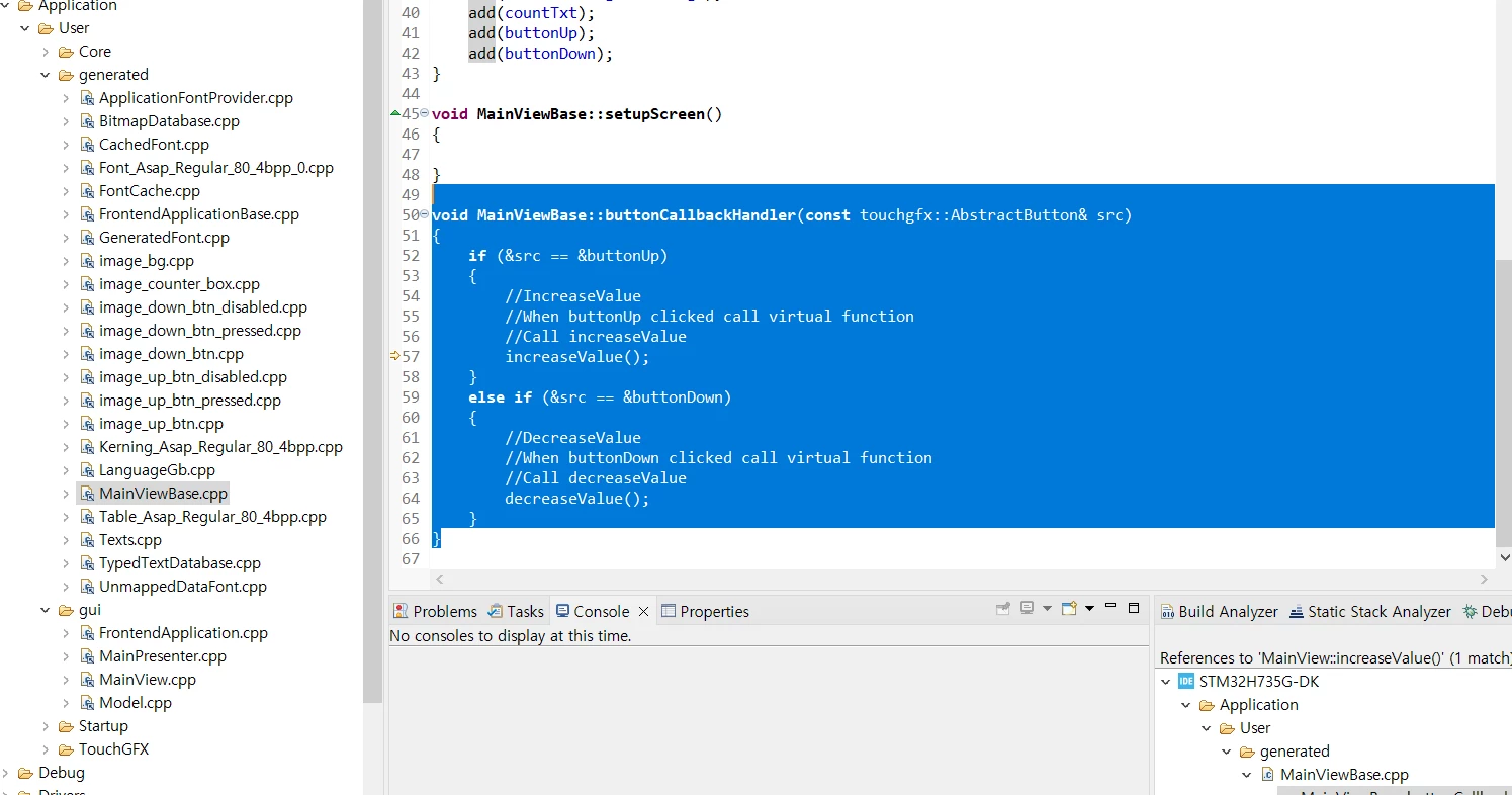

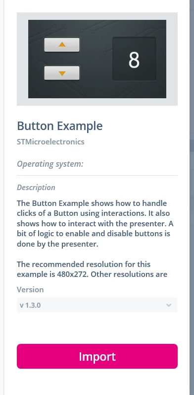

  1. The operation of the touch button was confirmed through the example of the existing TouchGFX.
0693W00000Nr65tQAB.png​
I reviewed the Button example in TouchGFX Designer.
0693W00000Nr65ZQAR.png​
As in the captured image above, I figured out the structure of the function that is called when the touch button is pressed using a break in MainViewBasee.cpp
0693W00000Nr66SQAR.png​
If you break the break in "void MainViewBase::buttonCallbackHandler(const touchgfx::AbstractButton& src)"
and look at each step, you can see that it is normally called with a normally defined function.

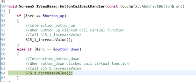

0693W00000Nr68JQAR.png​
However, the problem is that other functions are called in the project you created yourself.
It should be "SC5_1_decreaseValue" or "SC5_1_increaseValue",
but "void Screen5_1View::tearDownScreen()" is called.

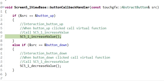

0693W00000Nr68dQAB.pngIf you apply the brake, press "botton_up" and confirm with a single step,
After entering the condition in button_up in the if statement, it is executed as the button_down part in the next step.
and
in the next step
will run as
There doesn't seem to be much difference compared to the example source that works normally, but what the hell is the problem?

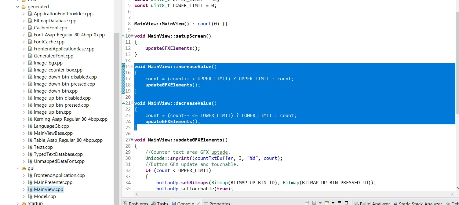

If you look at the captured figure at the bottom, it is a callback function for when the button is pressed, and there is a virtual function to be executed in that function.
-> increaseValue();
-> decreaseValue();

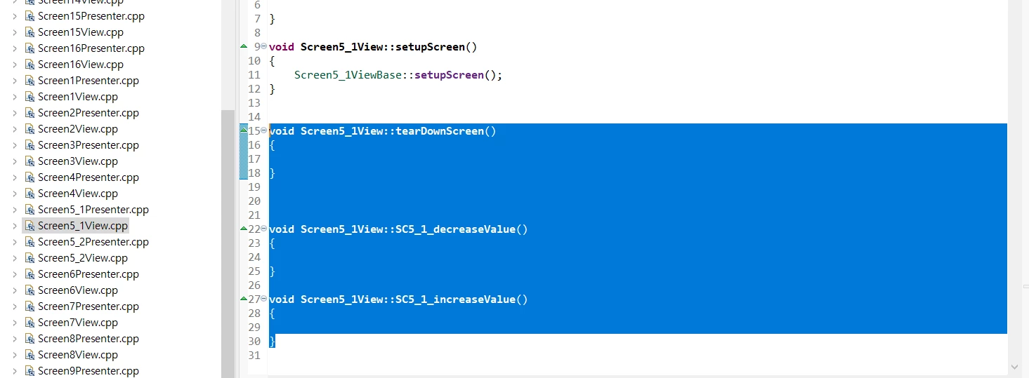

However, the function that is actually executed is teardownscreen().
even if you brake
Teardownscreen() is called even when running in single step.
The difference from the basic example is that the teardownscreen() function seems to have only a difference in definition.
There is no teardownscreen() function in the basic example.
mSH.1
mSH.1Author
June 3, 2022
I found a warin by myself
The problem was that I did not put anything in the virtual function in view.cpp in the gui folder.
