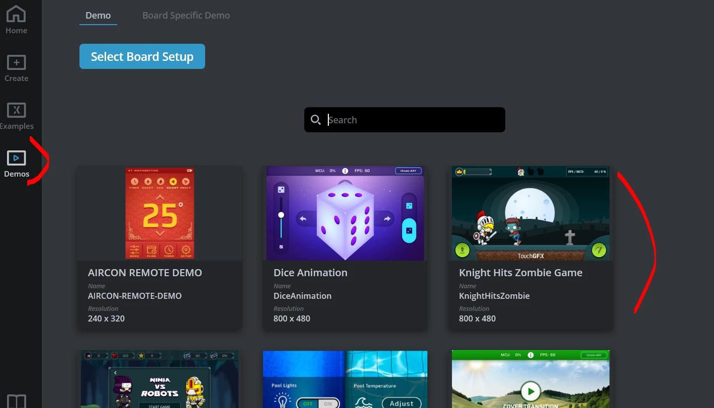

DNguy.14
Mar 6, 2023 9:51 AM UTC
Where can I get the source code of Knight Hit Zombie game?

Used "TouchGfx Desinger"​ could generate the source code of Knight Hit Zombie game.

Thanks you, I don't know it's an example already available in ToughGFX.
Romain DIELEMAN
Mar 7, 2023 7:28 AM UTC
You can find it in the Demos tab in TouchGFX Designer.
/Romain
DNguy.14
Mar 7, 2023 8:15 AM UTC
Thanks you, I got it.
