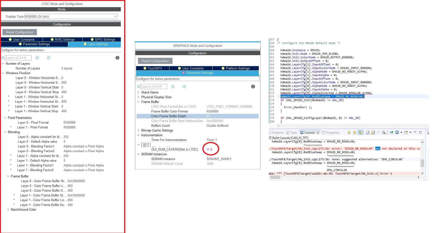

i used the STM32CubeIDE Version: 1.1.0 with TouchGFX designer 4.12.3 to build a project for the F746G-Disco. Everything worked fine, i was able to display animations etc.
Then, i made the changes to my custom board (based on Disco schematics) to use a 5 Inches (800x480) TFT and i was able to display some boxes/images but when i tried to display some animated images, the animation was not working (seems frozen).
The Touch panel is not configured yet, due to different driver than Disco.
Could this be a hardware issue? I am attaching the screen datasheet and the project, in case someone could help.

 I am afraid that with a display 800x480 you would need a 32-bit
  hsdram1.Init.MemoryDataWidth = FMC_SDRAM_MEM_BUS_WIDTH_16;
You can dump the LTDC/DMA2D registers to tell what's going on.
You can as well slow down the pixel clock to the lowest possible value. Not sure what the actual value is.
AN4861 table 12 says that with SVGA and 24bit you would need 32-bit SDRAM:
https://www.st.com/resource/en/application_note/dm00287603-lcdtft-display-controller-ltdc-on-stm32-mcus-stmicroelectronics.pdf

Tried both options, discovery can work with single or double. My board can not work with any option of RAM buffer
SKokk.1
SKokk.1Author
May 24, 2020
If i switch to RGB565, then everything is working.
I can not understand what is happening when i set RGB888, could be hardware limitation?

it should be related to the amount of framebuffers you're using. tGFX allows you to use 1,2 or 3. the 3rd is also called 'animation storage' so enabling that might help you a bit.
First I would make sure that your RAM is actually working - one can never be too sure ;)
when you have verified that it works you should have a look at the linker scrips and verify that you are using the external RAM for storage.
Then you can look into the amount of buffers you assign to the project. The 746-Disco can do all 3 buffers using the SDRAM so you should be able to do that as well.
SKokk.1
SKokk.1Author
May 27, 2020
I am not able to enable the 2nd framebuffer.
The .ioc is uploaded here in case someone can check it: https://drive.google.com/file/d/1foGZArtejr9RZqs7vX4vzj8qzmRgUweo/view?usp=sharing
I ran the "STM32Cube_FW_F7_V1.15.0\Projects\STM32746G-Discovery\Examples\FMC\FMC_SDRAM\EWARM" and seems RAM is working for the defined area. I do not know how to check the whole RAM area.

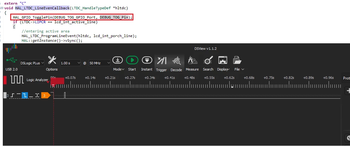

Do you see the LTDC interrupt getting fired: LTDC_IRQHandler -> HAL_LTDC_LineEvenCallback()?

Back with available logic analyzer...
It enters only 2 times

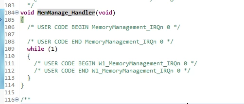

  And codes stucks at:
AME MCU Support Center BB
