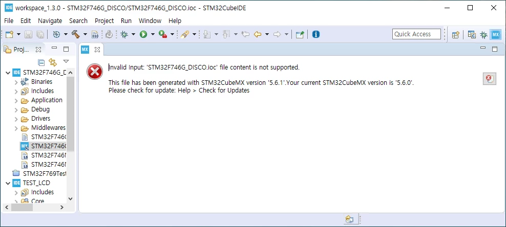

However, after creating a project using touchGFX, there is a problem accessing ioc files.
There is a message that the version is low.

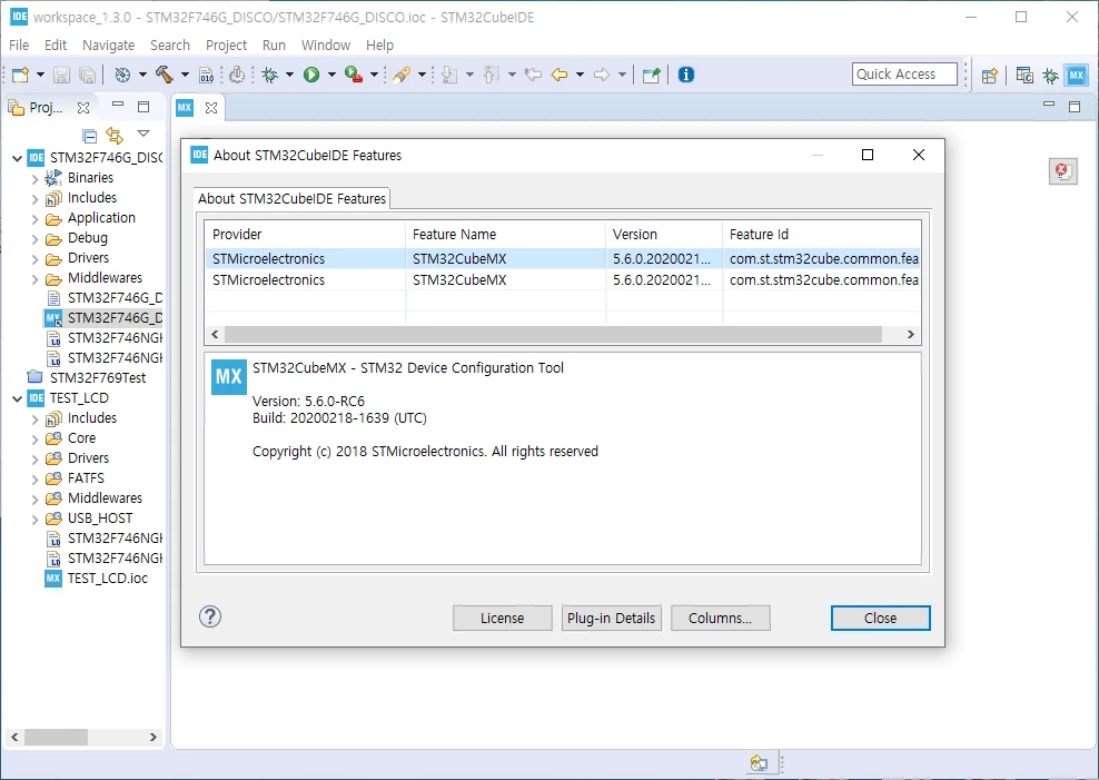

The program version is attached as a image.

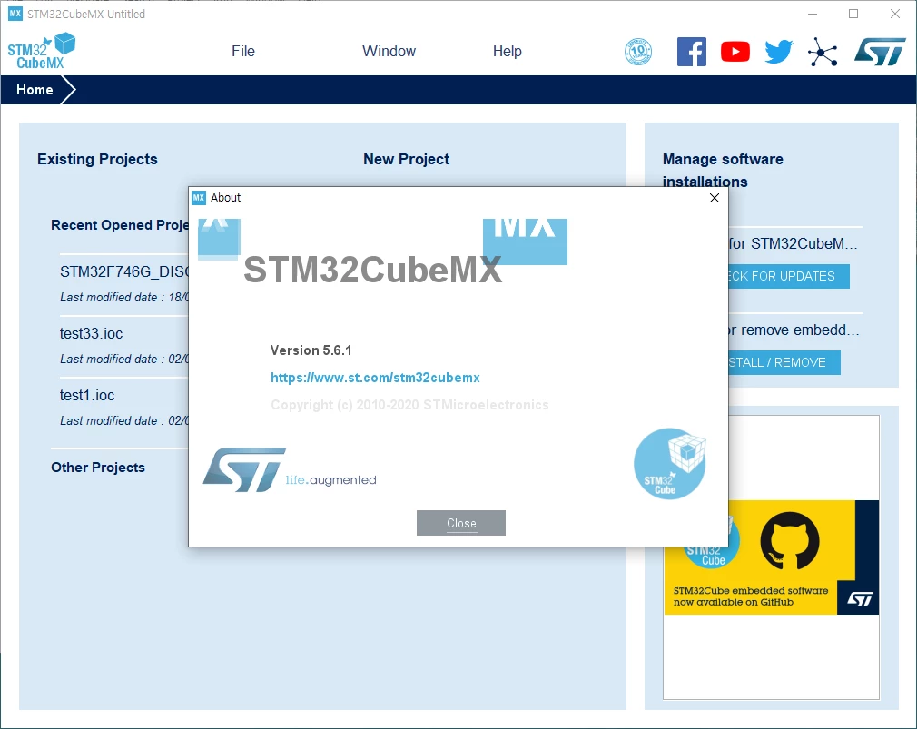

You are using on one side STM32CubeMX standalone tool version 5.6.1.
On the other side you're relying on STM32CubeIDE 1.3.0. Looking at Help > About then selecting "MX" icon you will see 5.6.0 embedded ...
Then you're facing regular behavior which is not possible to open a database release more recent than tool used to read it ...
Two way to solve your issue here:
1) Update you STM32CubeIDE 1.3.0 to 1.3.1 (Help > Check For Update ...) ... 1.3.1 is STM32CubeMX 5.6.1 compliant
2) DO not rely on STM32CubeMX standalone .... only rely on STM32CubeIDE ... Device Configuration Tool is fully integrated ...
