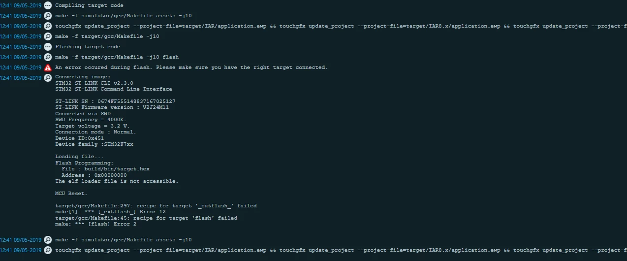

An error occured during flash.
I am trying to run a clock demo from TouchGFX 4.10.0 Designer for my STM32F769-DISCO.
But when i Run on target the detailed log shows the erroe:" there is an error occured during flash.  Please make sure you have the right target connected."
PS:I am sure that i have choose the right target.

Could you show me a screenshot of the error?
/Martin

youssef.amimi
May 9, 2019 11:46 AM UTC
Hi @Martin KJELDSEN​ this is a screenshot of the error0690X000008BT5eQAG.png
PS: I run the clock demo successfully on STM32F746NG

Can you please try updating your ST-Link? It seems your installation is quite old. ST-Link_CLI.exe is on v3.3.0.
Ca you try connecting through the ST-Link GUI, not in TouchGFX Designer.

May 9, 2019 1:08 PM UTC
I updated ST-link_CLI.exe on v3.4.0 and all the demos runs perfectly.
