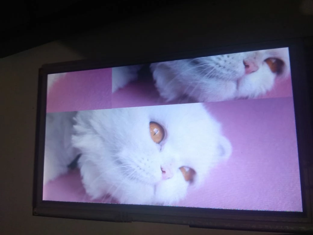

Hi! I have been trying to make things work for a couple of days. I'm using an Alientek Explorer developer board (STM32F407) and it the documentation is nonexistent. Everything is in chinese characters and it's been so hard to learn from examples when everything is unintelligible. Lucky me the new STM32CubeIDE is a breeze to use! It's so good the way everything is well connected!
I have this display: https://www.buydisplay.com/7-tft-screen-touch-lcd-display-module-w-ssd1963-controller-board-mcu
I'm not using DMA transfer yet. Trying to make the simpler way first and improve later.
I have been following the doc for "FMC and SPI Display Interface" and STM32F412G-DISCO example.

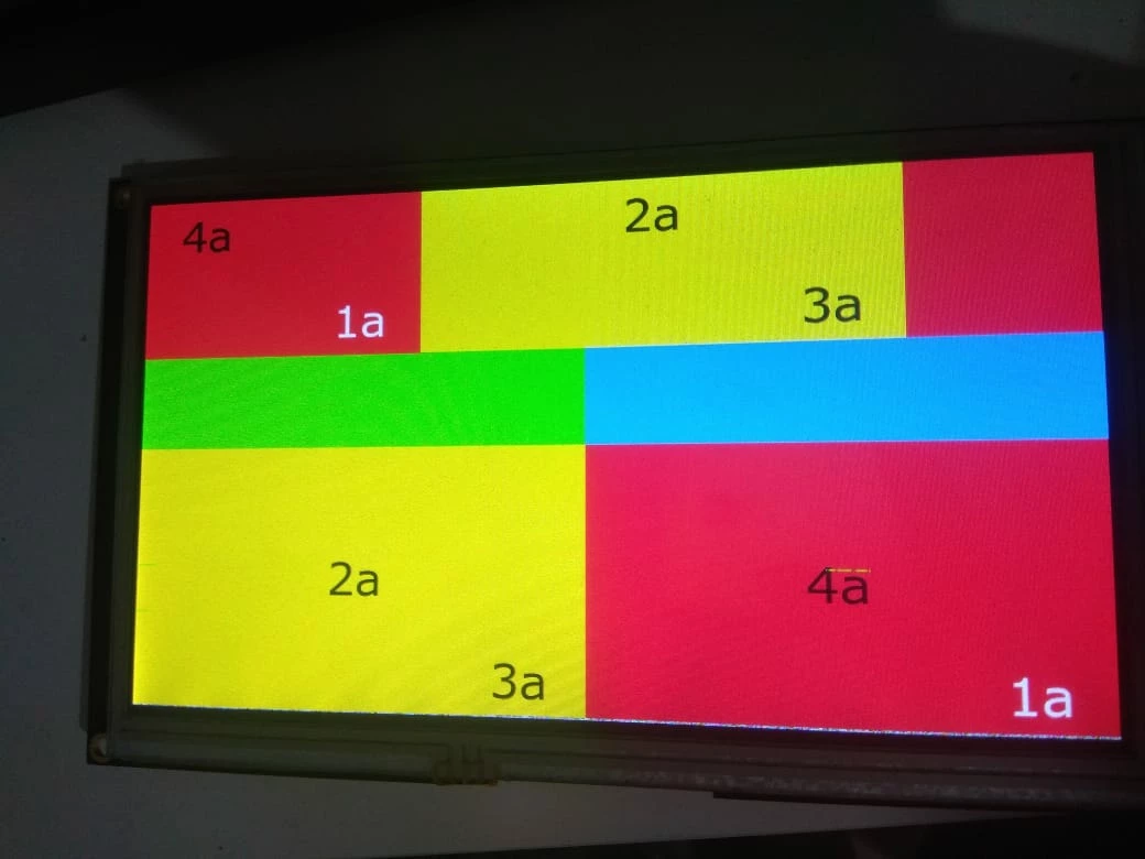

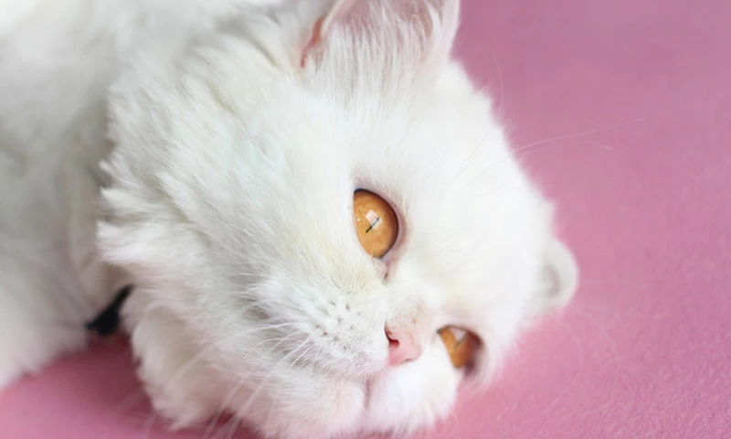

Someone could please help me to identify why my image is being drawn liek this? I suspect my buffer is the problem.
Designer:
Display:
Designer:
Display:
May the cause of this be here?
void TouchGFXHAL::copyFrameBufferBlockToLCD(const Rect rect)
 __IO uint16_t* ptr;
 int16_t height;
 // Use default implementation (CPU copy!).
 // This can be accelerated using regular DMA hardware
 for (height = 0; height < rect.height ; height++)
 ptr = getClientFrameBuffer() + rect.x + (height + rect.y) * 799;
 SSD1963_WriteMultipleData((uint16_t*)ptr, rect.width);
I've attached the entire project files, just in case someone wanna kindly give it a look! Thanks in advance!
 ptr = getClientFrameBuffer() + rect.x + (height + rect.y) * 800;
How much this should be advancing the buffer? Actually for each loop it's advancing 1600 (0x640). I don't know why it's not working as expected.
After initialization I can write to display and everything works fine. I can clear screen, draw lines, draw rects and filled rects. I guess it means my problem isn't related to the display initialization or drawing to the FSMC bus. TouchGFX is drawing line by line until the display is filled as expected. What is wrong? Any thoughts on this?
Tesla DeLorean
Guru
July 23, 2020
If the width is 800 pixels, the buffer should advance 1600 bytes for 16-bit words
Make sure the casting and math is appropriate as some of the computations will exceed 16-bit
There could be some initialization of the SDD1963 causing multiple tiles/windows rather than a linear frame buffer.
Read back the frame buffer.

I got it! I was suspecting on my SRAM configuration and the problem was on FSMC address configuration. It was set to 18 address pins and reading through the SRAM datasheet I noticed it has to be 19. I forgot to count A0!​
