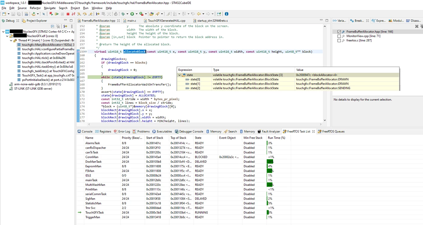

My HW:
  • NUCLEO-F446RE
  • Custom DISPLAY Board (TFT ILI9314, TPC TSC2007, SPI FLASH MX25R6435F)
My SW:
  • X-CUBE-TOUCHGFX 4.17.0
  • STM32CubeIDE Version: 1.6.1
  • STM32Cube_FW_F4_V1.26.1
  • FreeRTOS 10.3.1 with CMSIS_V2
Randomly and after some time (from 20 minutes to several hours) the TouchGFX_Task task hangs in the AllocateBlock function (FrameBufferAllocator.hpp).
The state of all blocks is other than EMPTY.
virtual uint16_t allocateBlock(const uint16_t x, const uint16_t y, const uint16_t width, const uint16_t height, uint8_t** block)
 drawingBlock++;
 if (drawingBlock == blocks)
 drawingBlock = 0;
 while (state[drawingBlock] != EMPTY)
 FrameBufferAllocatorWaitOnTransfer();
 assert(state[drawingBlock] == EMPTY);
What could be the problem ?
attached image of the debug session (drawingBlock = 2. state[2] = SENDING).
The other tasks work correctly
/Antonello

Hi
The DRAWN, DRAWN, SENDING states indicates that one block is being sent, the two next blocks are already drawn (ready to be sent next).
Therefore the application stops, waiting for the sending to finish.
If you are using DMA based sending, you should check if the interrupt was raised.
(a watchdog functionality (last resort), would be to fake the interrupt and fake that the block was sent).
Regards

Hi @Flemming Gram CHRISTENSEN​ ,
I can confirm that the problem is in the Display_Bitmap function (MB1642BDisplayDriver.c). In particular, HAL_SPI_Transmit (Display_Set_Area and DCS_WRITE_MEMORY_START) and HAL_SPI_Transmit_DMA fail.
I hadn't handled the error and the IsTransmittingBlock_ variable remained set to 1 due to HAL_SPI_TxCpltCallback callback never called!
Now I have to understand why. On that spi (SPI1) only the display is connected!
Without the FreeRTOS I have been testing it for days and have never had this problem.
Do you think I should use a FreeRTOS Semaphore instead of the IsTransmittingBlock_ variable ?

Jul 14, 2021 7:45 AM UTC
I think you should look into the the two HAL_SPI functions (you have the source code). Maybe write some global variables or set breakpoints in the "failure cases".
Would be interesting to know.
You could setup an error callback and set the istransmitting to 0 (or run the transmit complete code).
I do not think you should change to a semaphore. the main issue is that the UI must be able to see if SPI is running (if not then start, if it is, then do nothing).
