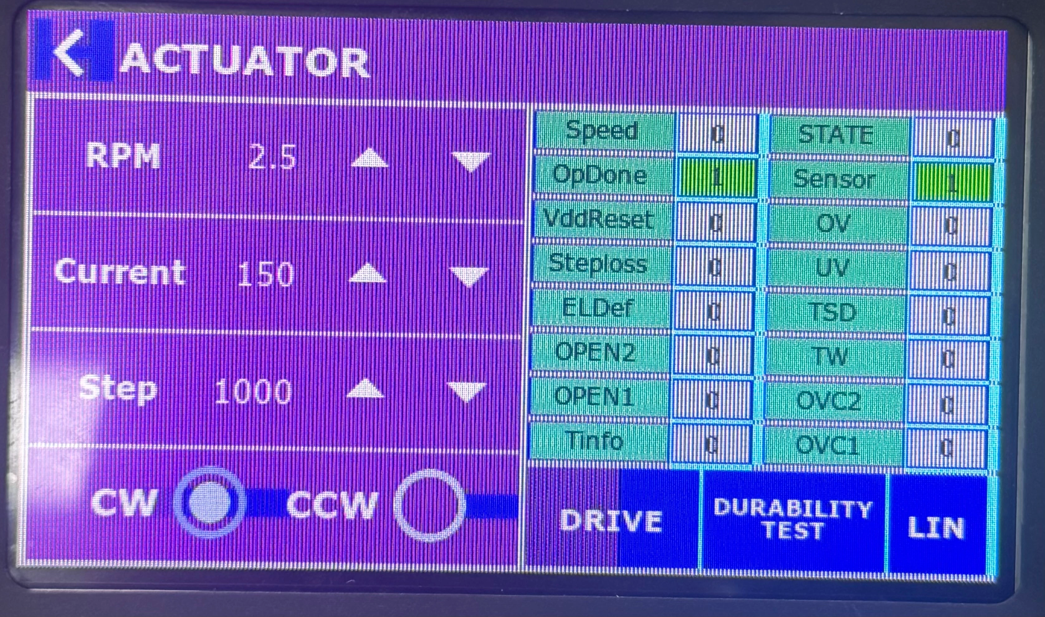

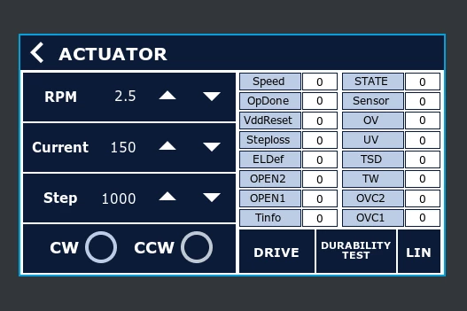

After I update TouchGFX to 4.26 version, Display color changed
I'm currently using Touchgfx after updating from version 4.25 to 4.26.
When I build and run the code generated by Touchgfx 4.26, Display color doesn't match the design in Touchgfx 4.26.
But When I do the same thing through Touchgfx 4.25, Display color matched very well.

Osman SOYKURT
Sep 29, 2025 8:27 AM UTC
Hello @MJKIM ,
Could you give more info about your application?
  • Which STM32 MCU are you using?
  • Do you work on a custom board or does this issue happened on a ST discovery board?
  • If this is your own custom board, which type of screen is this?
  • What's your framebuffer color format?
  • Does this issue happen on image assets/shapes/text elements?
  • Is there any transparency used?
  • Do you use image compression?
BR,

Jan 27, 2026 9:18 AM UTC
Hey, was this ever solved?
I've run into the same problem and even with GIT Control, and reverting to a previous version I knew definitely worked. Something with the IDE or/and TouchGFX is making the colours change after updating version.
Resorting back to a previous version of TouchGFX 4.25 and colours are still in a different state
Kind regards,
Andrew
