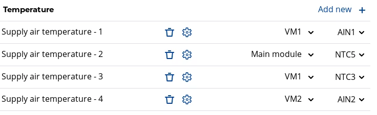

I'm faced with problem when I add elements to list. For better understanding I explain what I want to do. So here when I click add new elements I go to other screen where config pinout. And when I click save it stores names like "VM1", "Main module" in array there is placed in model.hpp. In list layout I can create 5 elements.0693W00000Y96nNQAR.pngWhen I add more than 3 elements to the list my names somehow which I store in array disappear and random values which is in my project enrolls
0693W00000Y96qRQAR.pngWhat can cause this problem?

Hello @heyo​,
That looks like an out-of-bound issue.
How did you create and initialize your array ?

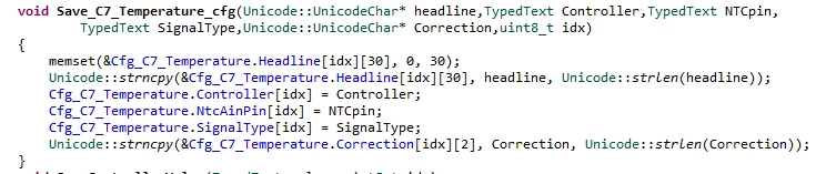

I create structure in model.hpp
0693W00000Y97haQAB.pngThis is how put information in to arrays
Yoann KLEIN
Jan 25, 2023 12:16 PM UTC
Can you also show me how you display your Array values into the screen ?
Also, why are you using 2-dimensionnal arrays for Headlines and Correction ?
