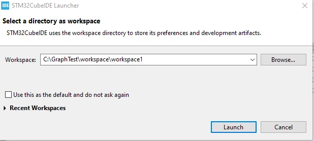

Attached my project. Just unzip the workspace, open workspace1\GraphTest\STM32CubeIDE\.cproject and use workspace1 as workspace directory.

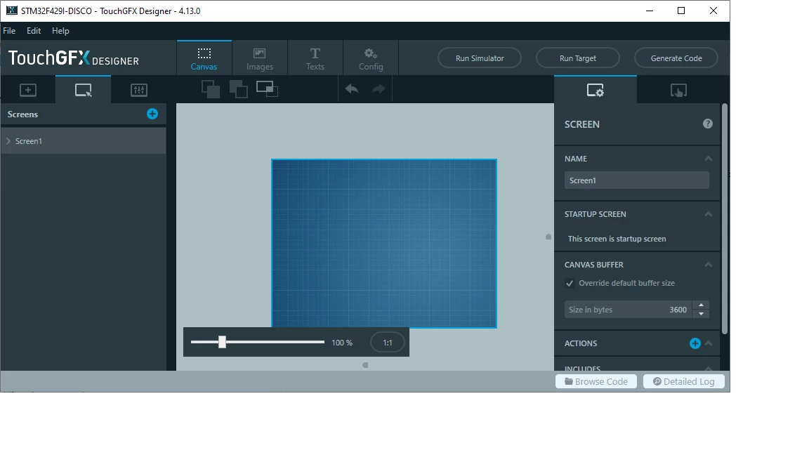

Edit 1:
I found that i should add a canvas buffer in main.c , i will try to convert the example main.cpp to main.c
Edit 2:
I added a canvas buffer 3600 to screen 1 through TouchGfx designer, and the graph line started to appear at last!
Best answer by HPam.1
Hello Alexandre,
My issue is resolved after adding the Canvas buffer. Though I don't know how to calculate the buffer size, I just punched in the default according to the example
Thank you very much, i'll try that graph example after I upgrade to 4.14.

Is your issue resolved ?
The project is pretty old so I will port it to the TouchGFX 4.13.0 as a simple GUI you can run in the simulator, so that you can then import it to any Application Template.
For you interest, a Graph widget is currently being made and will probably be available in Designer around October.
/Alexandre
Alexandre RENOUX
Visitor II
July 27, 2020
Hello again,
You will find enclosed the UI for the Graph example (made with TouchGFX Designer 4.14 available via the TouchGFX Generator in CubeMX 6.0.0).
I believe your issue was indeed the Canvas buffer.
Please when doing an application, always test on the simulator, it often gives pretty good insight on why it's not working when there's a problem.

Hello Alexandre,
