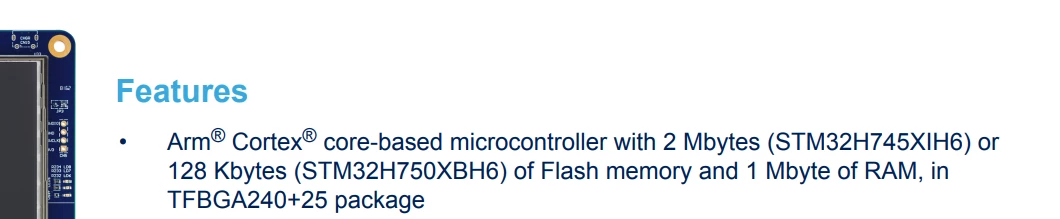

MM..1
May 13, 2023 7:29 AM UTC
In your question miss important info what mcu on your disco? 128k version is more difficult...
_legacyfs_online_stmicro_images_0693W00000bk0MgQAI.pngbut primary code for new display is more better start with right steps new project as convert existed projects.
Krautermann
Senior
May 15, 2023 7:53 AM UTC
Hi, the board has STM32H745XIH6, so it's 2Mbytes and not 128KB.
