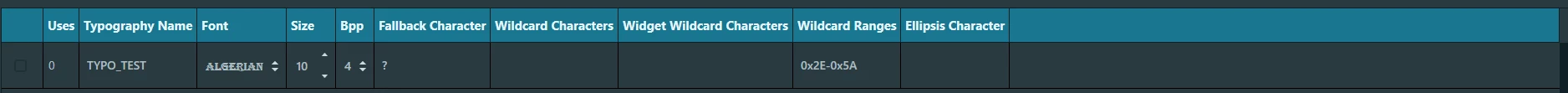

Based on naming in TouchGFX designer, I think I'm looking for "wildcard range" in code somewhere. But I haven't been able to find it yet.

I imagine you are looking for something like files located at "yourProject\TouchGFX\generated\fonts\src".
For example when i create this font with this range :0693W000005AXTQQA4.pngI can find these files :
0693W000005AXTuQAO.pngIn the last file Font_ALGER_TTF_10_4bpp_0.cpp you can find the declaration of all Unicode characters for your font
