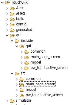

About using variables in TouchGFX
folder is model ,main_page_screen, pw_touchgfxactivev_screen.
I want to use the variables A declared in the model in main_screen and pw_page_screen. I don't know how to declare variables and how to use them.
For example, variable A is declared in model.cpp.
In pw_touchgfxactive_screen.cpp, enter 1 for variable A.
I want to use variable A in main_page_screen.cpp.
Thank you for telling me how to pass the variable A value entered in pw_touchgfxactive to main_page_screen.cpp.

Hello PKunk.1,
Completing the following tutorial should give you all the answers you need
https://support.touchgfx.com/docs/tutorials/tutorial-03
/Alexandre

Or use extern C in C++ : example
in main.c
int variableA; or volatile
in globals.h
extern int variableA;
in model.hpp include globals.h use extern C here
then when i remmember can use variableA on any place...
But you need choice what you need C++ setters getters private public ... or C or mix, and too important is who and where will change variableA.(gui,irq,spi,dma...)

By the way, in the case of Adata [7], struct Adata, can you tell me how it is delivered?
Romain DIELEMAN
Jan 12, 2021 8:57 AM UTC
Can you elaborate on what you are trying to do ?
/Romain
