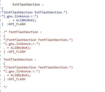

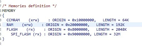

MKoca.1
MKoca.1Author
Senior
February 16, 2021
Firstly, thank you for your reply. I made the adjustments in the id file as in the pictures. The code is being compiled, but the pictures that should be on the 7 inch screen are not visible. I don't know how to set the external flash to memory mapped mode. Can you help me ?

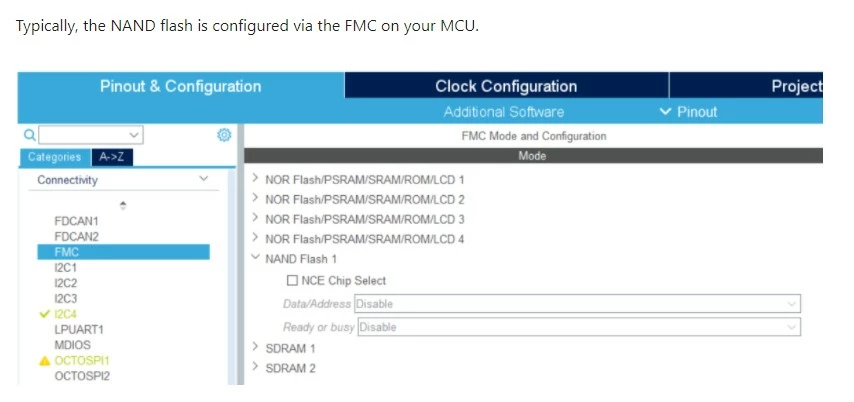

MKoca.1
MKoca.1Author
Senior
February 17, 2021
The block mode you said here is configured with FMC. The flash I used is W25Q128. Typical SPI configured with STM32F429 mcu. I'm very confused.0693W000008GNRdQAO.jpg
Tesla DeLorean
Guru
February 17, 2021
It is not going to work as an FMC device, that would be for 8 or 16-bit parallel memories, not QuadSPI
With QuadSPI FLASH on a F429, you're going to have to interface in 1-bit SPI mode, and transit data through an SRAM on it's way to video or frame-buffer handling software.
Would an F469 device work? That supports QSPI

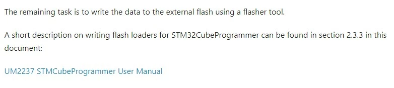

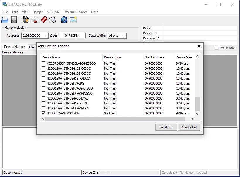

zzzzz
Senior
February 19, 2021
0693W000008GhFNQA0.pngI don't know how to make an external flash loader. But I found one spi flash loader in ST utility external loaders. There should have a way to make one.
Maybe post a new question to ask about this.
Hope you solve this problem.
Tesla DeLorean
Guru
February 19, 2021
It is basically a byte field in the loader header that specifies it being an SPI_FLASH
I'd need to know the pins and SPIx involved to port the W25Q128 loader over to an F4
