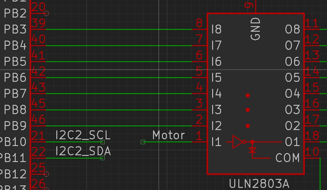

Hi, reading/writing groups of bits at once is "very usual":
