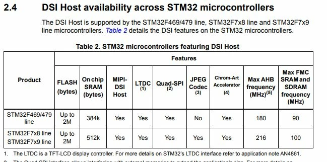

Hello @ilyus​ and welcome to the STM32 Community =)
I recommend to take a look at these resources available on the ST website:
  • AN4860 Application note DSI Host on STM32F469/479, STM32F7x8/x9 and STM32L4R9/S9 MCUs, providing guidelines and practical examples on how to configure the DSI Host
  • AN4861 Application note LCD-TFT display controller (LTDC) on STM32 MCUs, providing guidelines on how to use and configure the LTDC peripheral to obtain the best graphical performances.
 0693W00000AMLLEQA5.jpgHope this helps you.
Please mark my answer as best by clicking on the "Select as Best" button if it helped :smiling_face_with_smiling_eyes:.
Imen

This is pretty useless information, I've read all of this several times. These are specs of MCU, not specs of DISPLAY. The fact that MCU can output 9000 different frequencies doesn't mean this specific display supports them. So sorry, your answer is not correct :(

Hi @ilyus​ ,
I'm sorry that I couldn't help you.
In fact, LCD specs are generally confidential, this is why it is difficult to find documentation.
I would therefore advise you to contact the LCD display provider, they may help you more about the specs.
Imen
